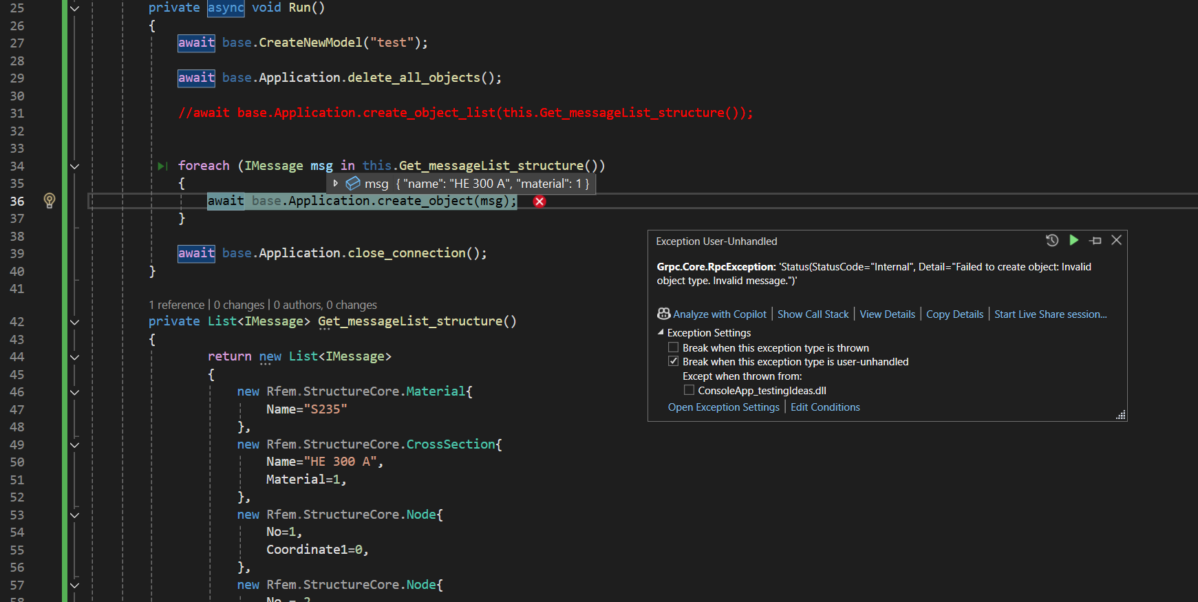

using the Dlubal.API Nuget package versions 2.12.11 or 2.12.10 together with RFEM 6.12.0010, I tried to recreate the C# example on the documentation page here, but I get the following error:
the IMessage creating the cross-section fails.
Below is my code:

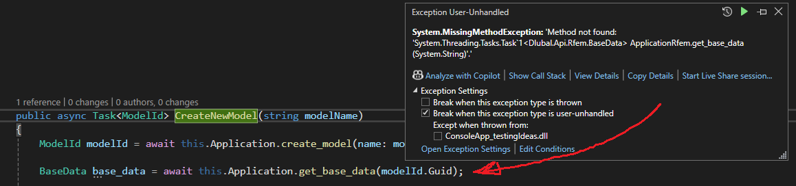

The API recommends the use of API version 2.6.10 with RFEM 6.12.0010. But, using that API version breaks other places in the code, as shown below.

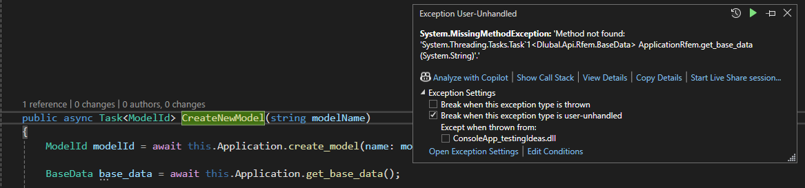

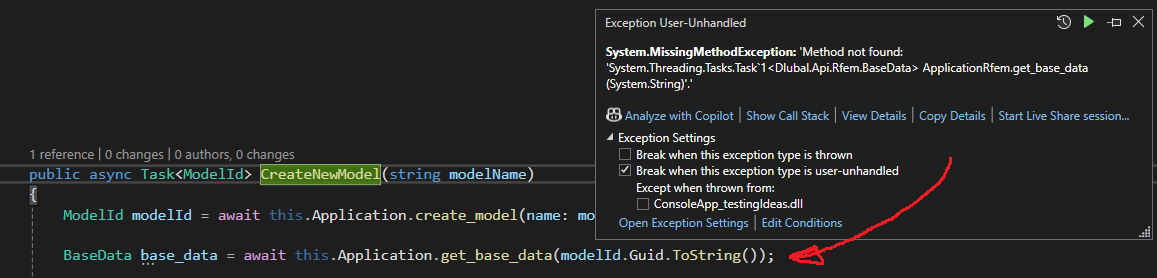

trying it without the .ToString() method, gives the same error:
trying it without giving any inputs to the method (like how it used to work with v.2.6.11) also gives the same error:
commenting out the line for getting the base data, arrives at the same problem mentioned at the top of this post.

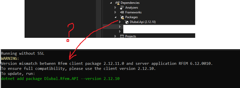

The other issue is that even when I have the API version 2.6.10 installed, I still receive the warning message that there is incompatibility and I should install version 2.6.10!

Regarding the version mismatch error, unfortunately I can’t provide further details at the moment.
Hi PSA001,
Could you please try deleting your NuGet packages from the following path:
C:\Users\YourUserName\.nuget\packages\dlubal.api\
Once done, try installing the package again by running the following command:
dotnet add package Dlubal.Api --version 2.12.12
Make sure to adjust the version according to the RFEM version you're using (e.g., 2.12.12 for RFEM 6.12.12).
I hope this resolves both issues.
