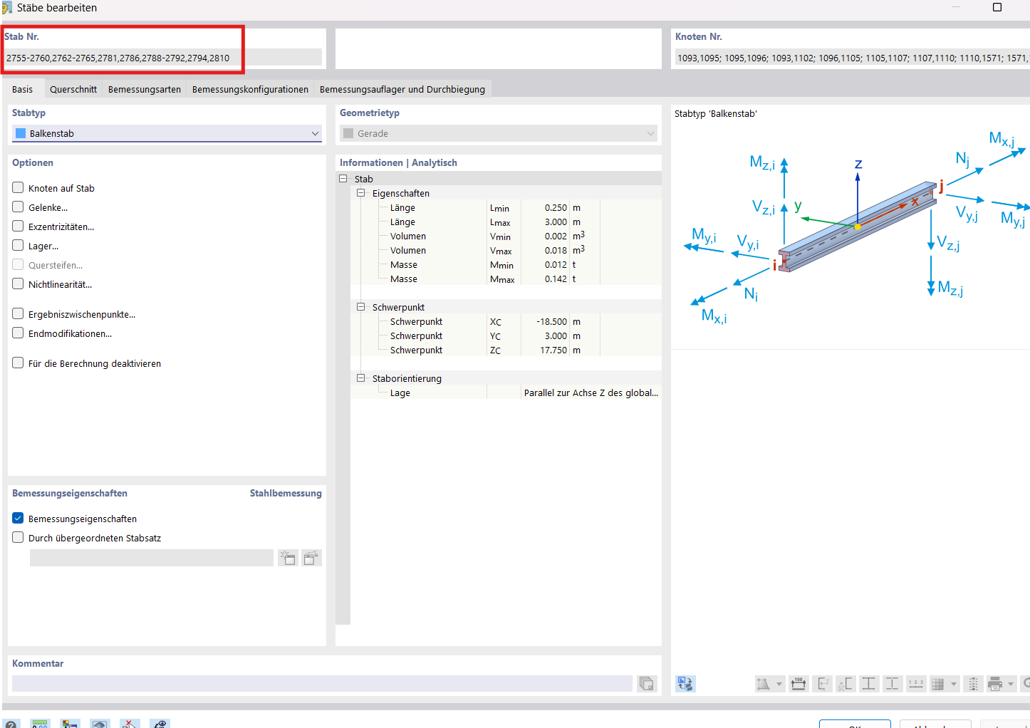

Good day,

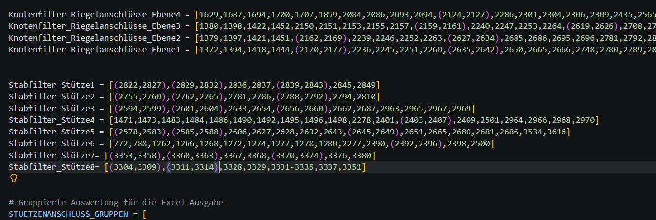

I am still managing numerous proofs of connections/bends, etc., using external programs/Excel sheets and transferring the section forces at the relevant points via the API. Especially with larger models or many variant considerations where node numbers/member numbers, etc., change frequently, it's still relatively time-consuming to properly "fill out" the scripts. My current workflow for the connection and stability proofs is as follows:
  1. Creating arrays for each support and all connections in the corresponding planes:
  2. Selecting the components in the GUI:
  3. Double-clicking on one of the selected components for the list
  4. Copying the list and pasting it into the appropriate array in the script.
  5. The annoying part is that the list always appears with dashes; so if Python copies the list directly, it would subtract the component numbers rather than including all components from-to. As a result, I have to either write out every single number from some lists afterward or modify my programming code so that I convert [507-509] into [(507,509)]. Neither seems optimal since, first, it is time-consuming and, second, tends to be error-prone, especially with very large sets of numbers. Therefore, my question is ==> is there any way to display the numbers of all selected components differently so that they can be inserted directly into the Python code? If not, could this possibly be developed?
I would be very pleased to receive feedback. Best regards,
Nick Böttcher
