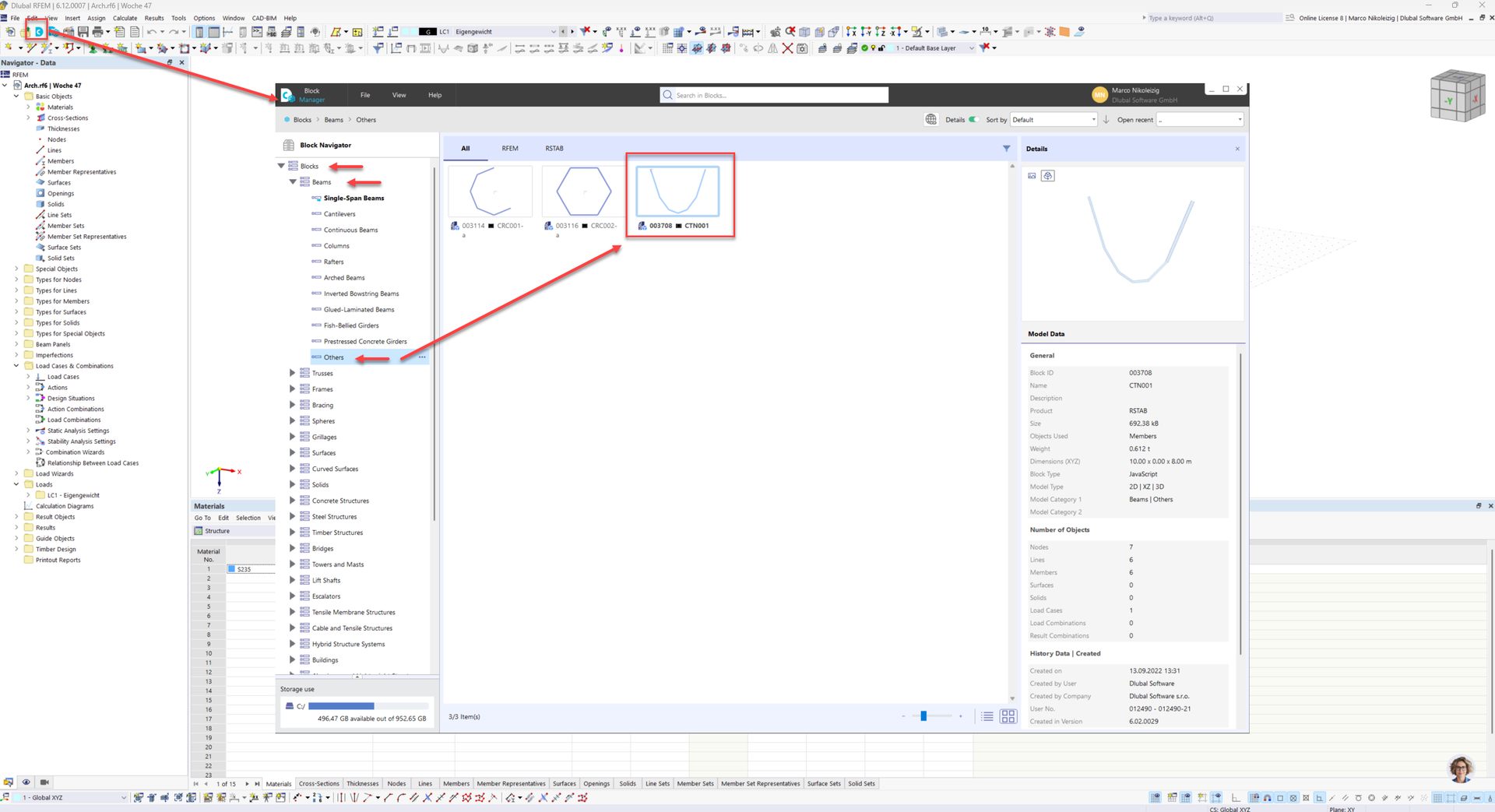

Thank you very much for your request! ![]()
The generators for creating various structurs are now managed as blocks within the Block Manager .
You can find a detailed guide on our Dlubal website explaining where to locate the Block Manager and how it works:
https://www.dlubal.com/en/support-and-learning/support/faq/005262
In the category “Blocks-Beams-Others” , you will find Block No. 003708 , which allows you to generate an arch.
A double-click on the preview image inserts the block directly into your model, as shown below:
If you have any further questions, feel free to ask — we’re happy to help!
