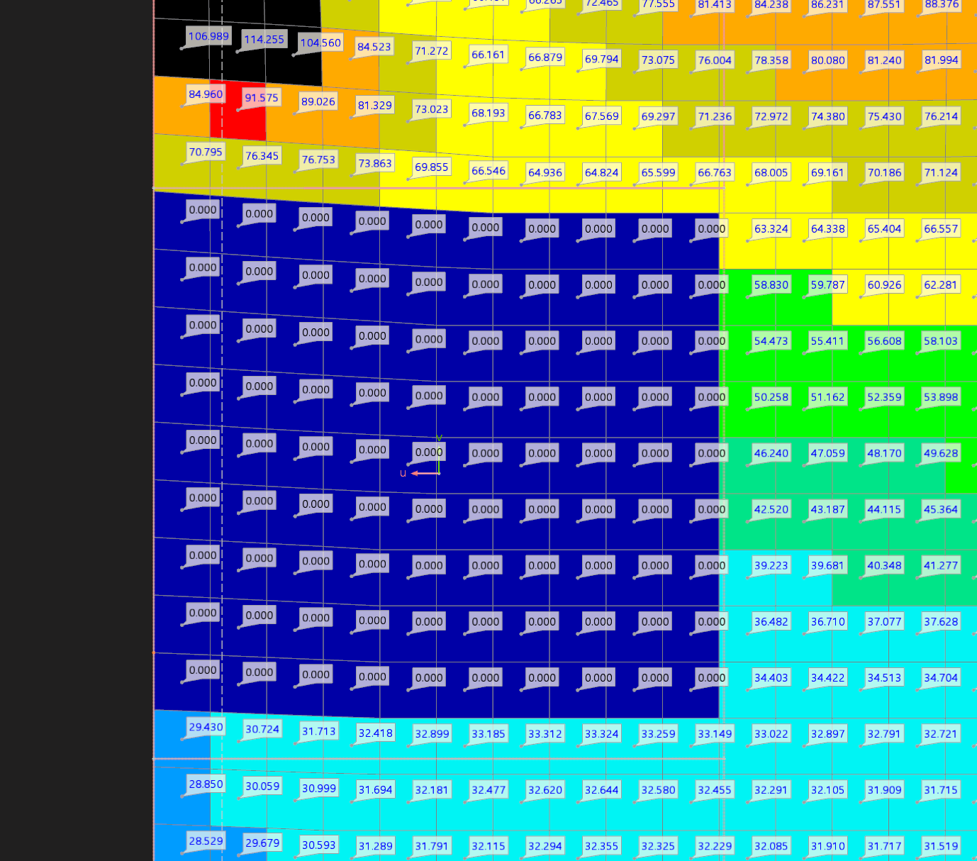

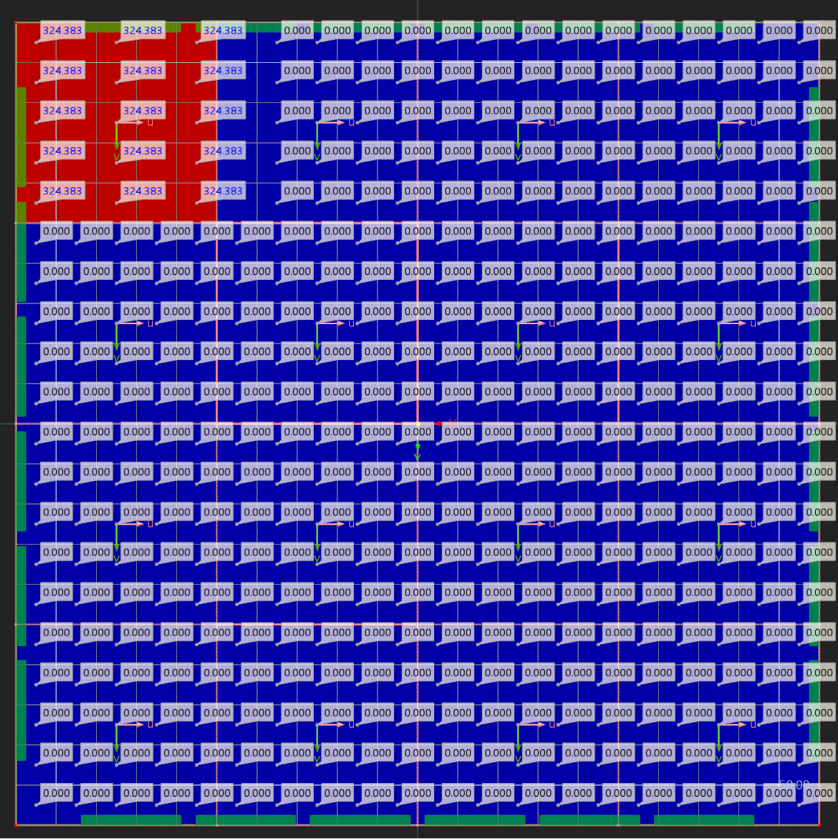

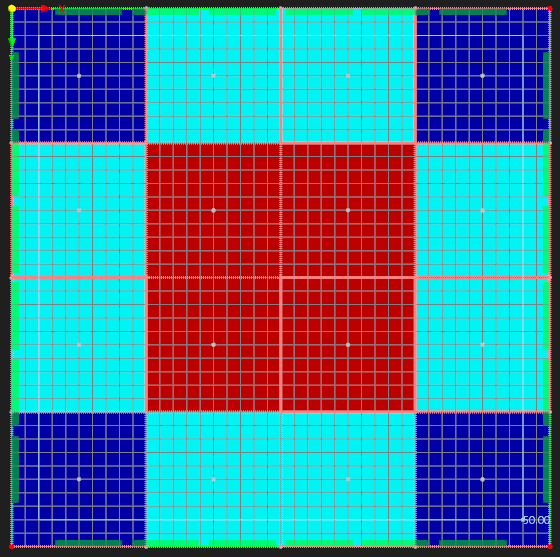

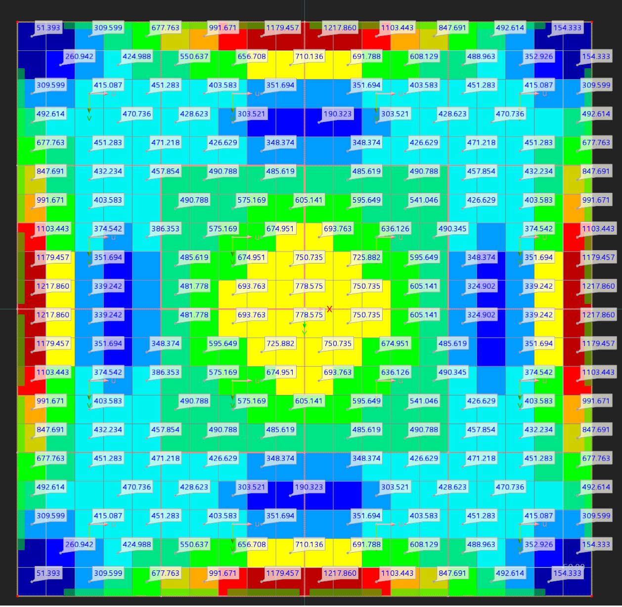

Hi, thank you for reaching out. For the sake of simplicity, I created a very simple model (see attached). It’s a 2 m × 2 m square with a 0.5 m × 0.5 m grid using “Surface Results Adjustment”:
Average stress test.rf6 (1,1 Mo)
kind regards,

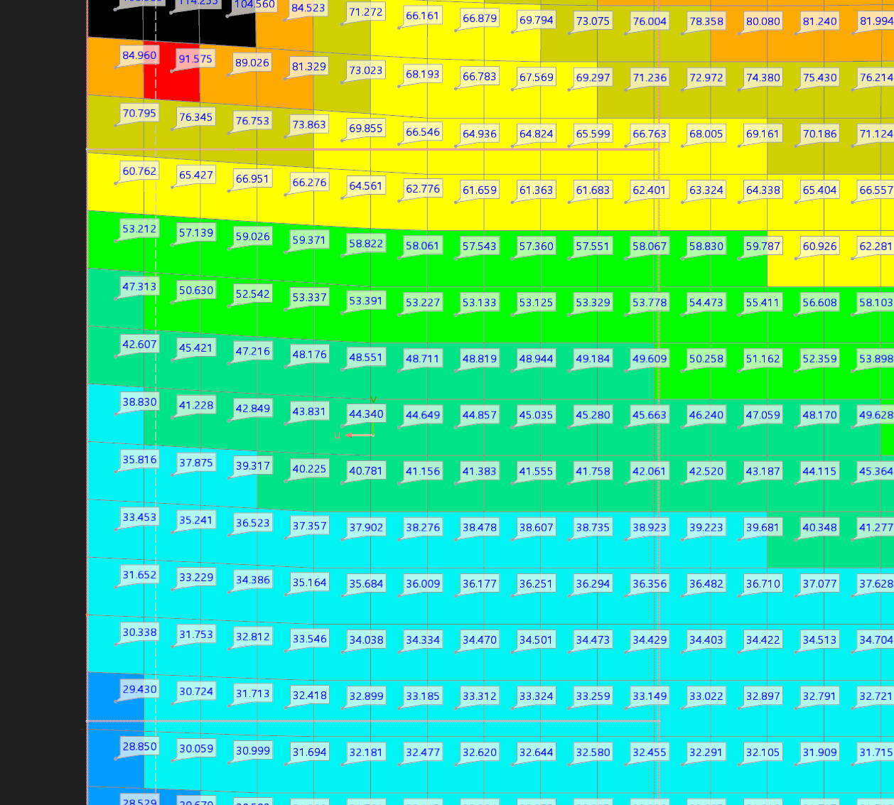

Thank you for the file. It is about the FE-Mesh somehow. If you reduce the FE-Mesh size to 50mm, all looks good. I have no idea why the 100mm does not work. I will forward this issue to the programmer.
The problem has been optimized and the smoothing now also works with 100mm FE mesh.
