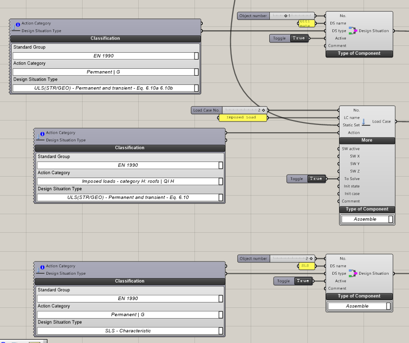

Design situation type cannot be read accordingly. It only appears to function for the SLS cases, any other it tested gives an error. (1. Object: Design Situation No. 1
Attribute: Design situation type
Error: Invalid design situation type.)

This has been solved, the code that the component outputs is incorrect and can be fixed by using a template file and exporting the Design situations from that files. You can than turn this into a value list of your own for further projects.

The support that helped me made this in the file with text explanation. I hope this is more clear. Otherwise there is also a video but its to big to attach here.
Square quadrilateral grid_dlubal.gh (101.5 KB)
Hi vform_rudi,
I have attached a GH-file containing a step-by-step explanation of how to import the correct design situations and use them for further projects as a value list.
Design Situation - Import ENG.gh (24.8 KB)
