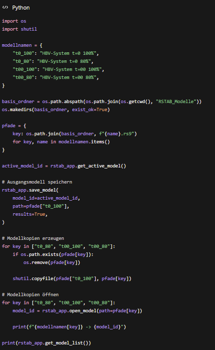

My approach was to save the original model under different model names, then open, modify, and read all models. However, I noticed that the models created this way have the same GUID (Model ID) as the original model. This makes it difficult for me to specifically switch the active model or to address the models uniquely.

One small tip, if you want to post example code again, please format it accordingly:
This way the code can be used via copy & paste, images are rather superfluous for that.
