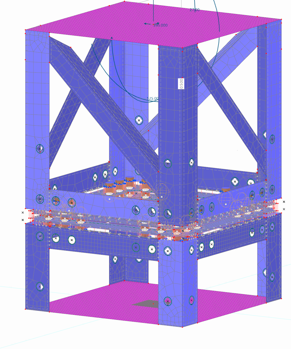

I am currently creating a type static analysis for a special steel connection using FE.
For this, I initially modeled all components that could be modeled using the Steeljoints addon and then continued working within the submodel. Since the model is quite large, the calculation time is relatively long for my investigations, which is why I am considering changing the analysis settings. Although I calculate several load steps, I do this manually using many load cases that I create myself and therefore wonder to what extent the settings of the 4 load steps, which are automatically preset after downloading the submodel, are really necessary? Do these load steps effectively affect the material or geometric stiffness matrix? (According to my assumption, these should already be covered by the Newton iterations alone regardless of setting multiple load steps, but I am not deeply familiar with this or do not have reliable information on this matter). I would be very grateful for feedback with a detailed answer regarding the background of the default settings of 4 load steps for the submodels of the steel connection addon.
