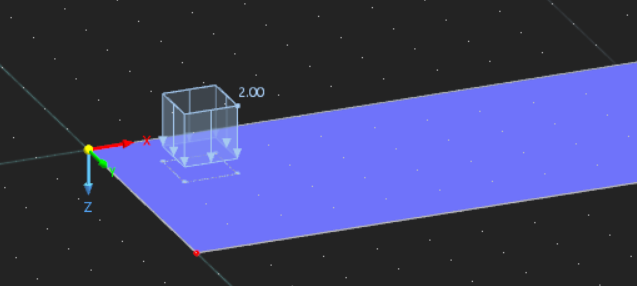

You could also define a Free Polygon Load with a series. The definition of the Load Location could be tricky, depending on your surface and the number of loads.
I attached a simple GH file with a moving free polygon load that may help you with your definition.
Moving free polygon load.gh (30.0 KB)
If you have further questions, feel free to ask.
