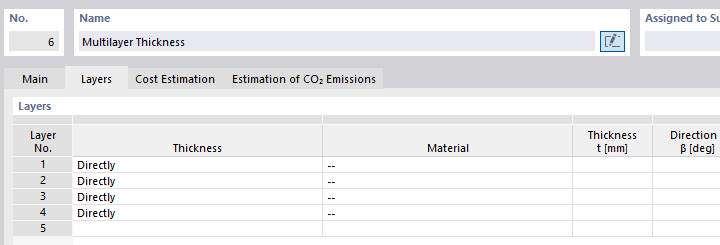

I’m trying to create a multilayer thickness using the RFEM 6 API, but I’m not being able to set the layers in the ‘Layers’ tab. I thought it would be by using the ‘layers_reference_table’ atribute of the Thickness object. My code is as follows:
        thickness_multilayer = rfem.structure_core.Thickness(
            no=6,
            name="Multilayer Thickness",
            type=rfem.structure_core.Thickness.Type.TYPE_LAYERS,
            layers_reference_table=rfem.structure_core.Thickness.LayersReferenceTable(
                rows=
                    rfem.structure_core.Thickness.LayersReferenceTableRow(
                        layer_no=1,
                        no=4
                        layer_no=2,
                        no=5
                        layer_no=3,
                        no=5
                        layer_no=4,
                        no=4
It shows no error when creating the object and a multilayer Thickness is created, but the layers in the ‘Layers’ tab are empty:
I would like to know if this functionality is already implemented and if so how is it supposed to be set?

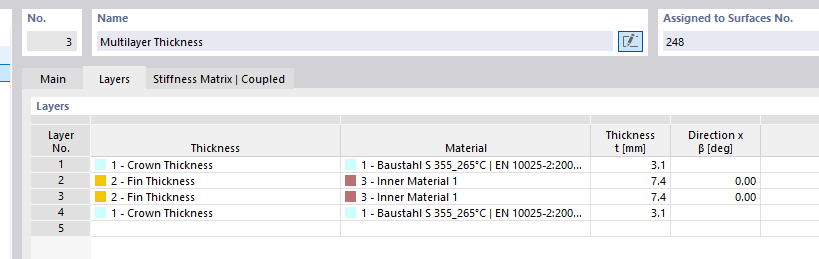

Hello @robert.milrath
Sure, please find it attached. I’m trying to create the thickness in the picture.
thickness_test.rf6 (1,1,MB)
Hi Pedro_Guimaraes,
this is a gap in the API and is already reported to the dev team (Todo 27928). We will let you know via the usual channels once this issue has been resolved.
