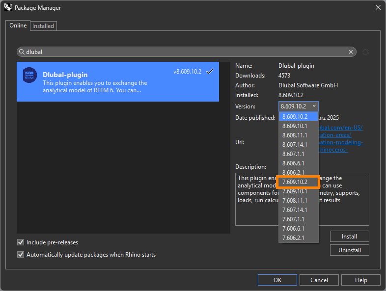

Hi Mark1,
In the Rhino package manager you can select from two different plugin versions: 7.X and 8.X
The version 7.X runs on .NETFramework and can be used in Rhino 7 and 8.
The version 8.X runs on .NETCore and can only be used in Rhino 8.
So, install the latest version of 7.X if you want to work in .NETFramework :rocket:
