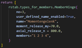

I am currently writing a Python script to create an RSTAB model via the Dlubal API.
I have the problem that when trying to create a hinge, I can only successfully specify the hinge number.
Unfortunately, the other attributes, such as the stiffnesses and member assignments, do not work.

According to the API documentation, this should actually work.
I am using RSTAB 9.11.0007 with the corresponding API.

If you separate the bar numbers with a comma, the assignment should work as expected. If there are still problems, it could be due to the old version. The current version is 9.12.0013. With this, everything works as expected.

for the joint assignment, I initially managed by assigning directly to the members. Unfortunately, inserting commas into the string did not help.

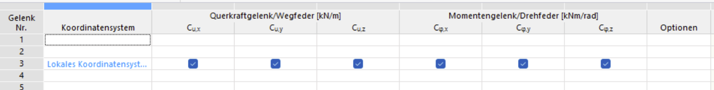

However, the problem remains that regardless of the stored values for the degrees of freedom, a checkmark is always set for all six DoF.

after the update to the latest API in combination with RSTAB 9.12.0013, everything is working again now.
Thanks again for the help.
