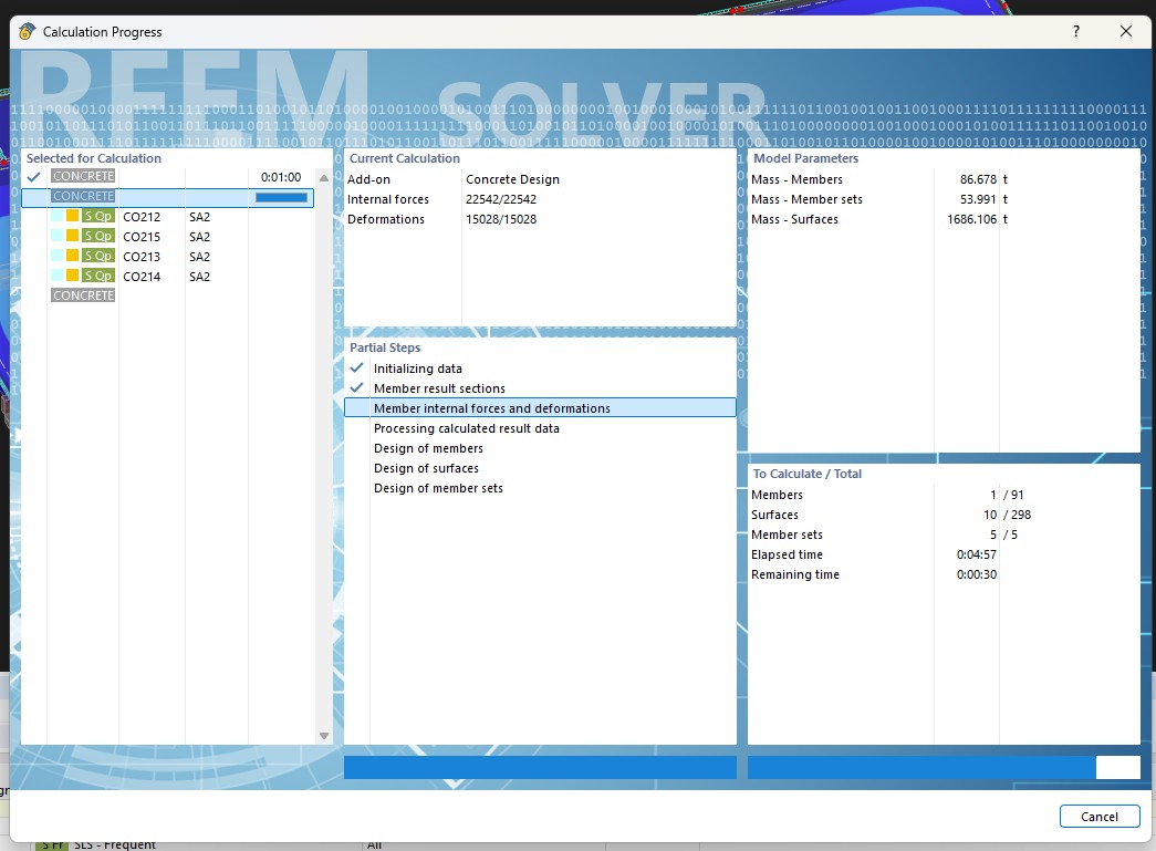

Hello, while trying to do SLS design on concrete member, member sets and surfaces, program crashes toward the end of calculation. First I did ULS and seismic design, which works fine. Here is a screenshot of the calculation progress.
Probably I have some settings that cause this or maybe there is a bug. Could you please check my settings? I can send file via private message.

I’ve looked into the issue. It turns out to be a bug in the concrete calculation. We’ll fix it as soon as possible.
