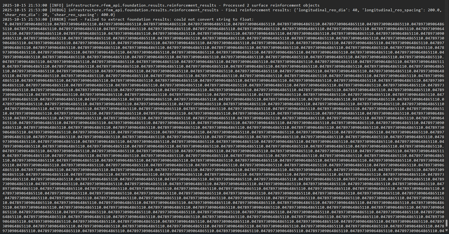

ValueError: could not convert string to float: '0.047897309064865110.047897309064865110.04789730906486511...'

In 6.12.0002, the u_z column contains concatenated strings like '0.047897309064865110.04789730906486511...' instead of numeric values. This worked fine in 6.11.

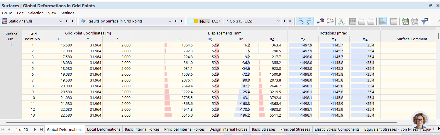

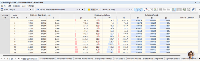

The results are present in the RFEM6 app UI.

I am a glass half full type of guy, so on the bright side at least the error creates quite a cool pattern.
