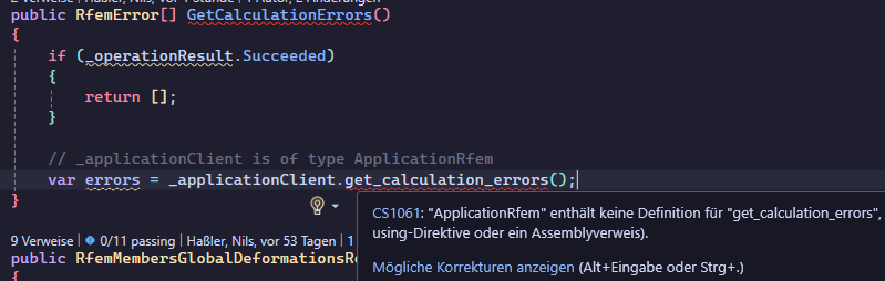

However, in the gRPC version, the method doesn't appear to be available. I tried this:
public RfemError[] GetCalculationErrors()
	if (_operationResult.Succeeded)
		return [];
    // _applicationClient is of type ApplicationRfem
	var errors = _applicationClient.get_calculation_errors();
But get_calculation_errors() is not defined in the gRPC client interface.

Hi hasslernils,
please have a look in the documentation. Under the topic https://apidocs.dlubal.com/source/rst_methods/rfem/get_result_table.html you'll find all necassary informations.
Here is a small example how it works:
df_error_and_warnings_table = self.rfem_app.get_result_table(
                table=rfem.results.ResultTable.ERRORS_AND_WARNINGS_TABLE,
                loading=self.relevant_loading_DS1
            ).data
It is also a good idea to have a plausibility check before you're doing the calculation.
plausibility = self.rfem_app.plausibility_check(
                type=common.PlausibilityCheckType.PLAUSIBILITY_CHECK_CALCULATION,
                skip_warnings=True
if not plausibility.succeeded:
... your logic
I hope this answers your question.
Happy coding.
See a code snippet using C# client 2.12.3:
Common.Table resultTable = await RfemApp.get_result_table(
    table: Rfem.Results.ResultTable.ErrorsAndWarningsTable
Console.WriteLine($"\nResult Table:\n{resultTable.Data}");
