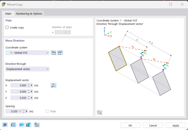

Idea: Can you provide a method or modifying class object for functionalities you have in the GUI? for example, a class named 'move_or_copy' with the same inputs as in the GUI?

I’m sorry but the manipulation functions like move, rotate, scale… are not implemented in the API the moment.
