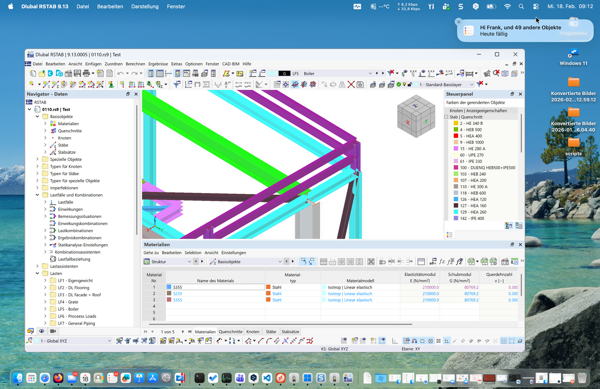

RSTAB runs smoothly under Parallels Desktop. Sometimes there are minor issues with the display of nodes.
I usually use RFEM and RSTAB in Coherence Mode. That works very well.
grafik
If you use the Dlubal Center, I recommend switching to full-screen mode.
In general, it is advisable to connect a mouse for operating RSTAB. Operation with the touchpad is not well suited for RSTAB and RFEM.
