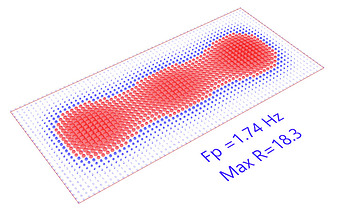

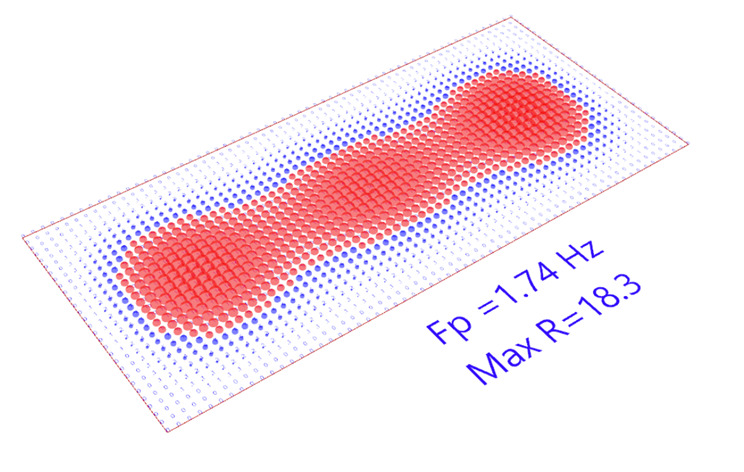

Really much looking forward to reviving a script and workflow which was working very nicely with the RFEM 5 API for vibration analysis using modal results from RFEM:
