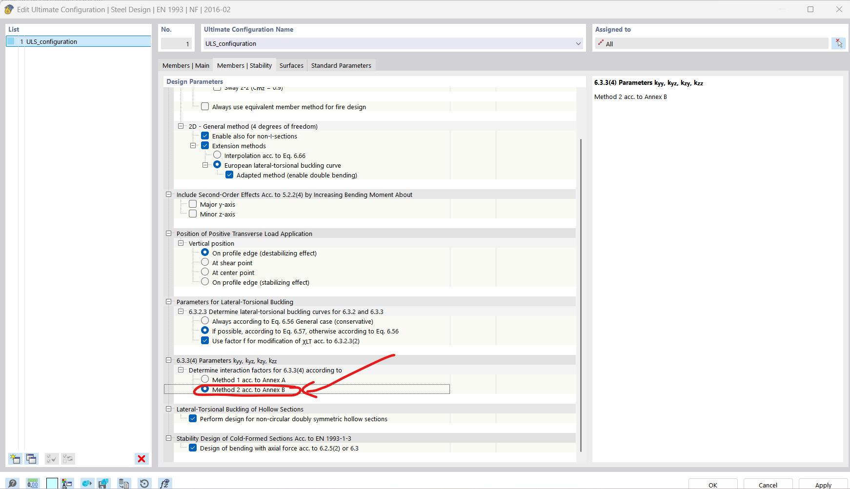

Bonjour,
Je souhaiterai savoir comment je peux activer la méthode 2 (annexe B de EC3) pour calculer kyy, kyz, ...Auriez-vous une ligne de code que je peux utiliser ?

The two keys of that group are the radio pair in the dialog:
6.3.3(4) Parameters kyy, kyz, kzy, kzz
  Determine interaction factors for 6.3.3(4) according to
    ( ) Method 1 acc. to Annex A     <- param_k_annex_a
    (o) Method 2 acc. to Annex B     <- param_k_annex_b
They are mutually exclusive, so setting param_k_annex_b to True clears
param_k_annex_a on its own. You can still set both explicitly if you prefer
to be unambiguous, the result is the same.
