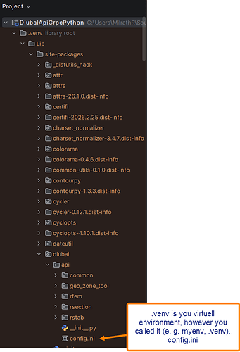

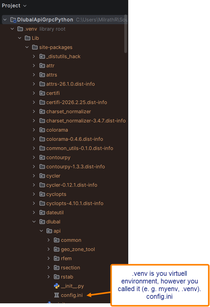

if you're working in a virtuell environment as described under Python Client — Dlubal API documentation, the config.ini should be saved here:
Please read also Authentication — Dlubal API documentation
Please make sure that you have defined a default value in the config.ini:

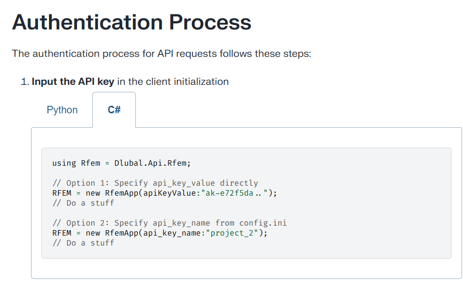

Maybe it would be helpful to update the documentation which led me (and maybe others) to think that this was also supported for the C# client:
