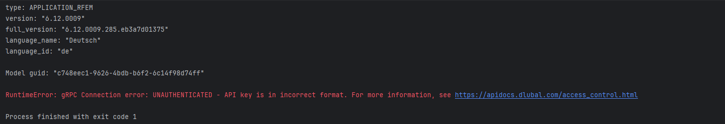

I copied the code from the examples in the Dlubal library. When I run the code, the following error message appears:
image.
RFEM starts a new model. So the connection works, but nothing else is executed.
Here is my code:

Are you using the API II key that starts with "ak..."?
Hi Stefan,
thank you for the quick response. Yes, I am using the API 2 key. The connection to RFEM is working as well. A new project is created, but nothing else.
Ashraf Mohsen
Hi Ashraf,
it seems that you have forgotten to remove or comment out the example (line 153 to end of file). There the script will create another project in RFEM with an empty key wich doesn't work in your way.
