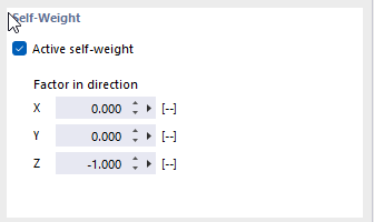

I would like to split the self-weight of the structure into different load cases in RFEM. For example:
• self-weight of steel members in one load case,
• self-weight of reinforced concrete elements in another
This is also required in cases such as the Equivalent Lateral Force seismic method, where only the weight of the superstructure should be converted into horizontal inertia loads, while foundations are not contributing to seismic inertia forces.
I could not find a way to enable or disable self-weight for specific parts of the model. The standard self-weight option applies to all elements in the model, without any filtering by material, group, or geometry.
