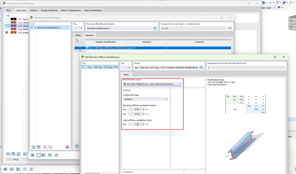

You can manage the stiffness reduction in RFEM through Structure Modifications using the modification type 'ACI 318-19 Table 6.6.3.1.1(a)' as shown in the image below:
The Concrete Design add-on fully considers this stiffness reduction.
This interaction is required by the code and is fully linked between the RFEM stiffness reduction per ACI and the Concrete Design add-on.
