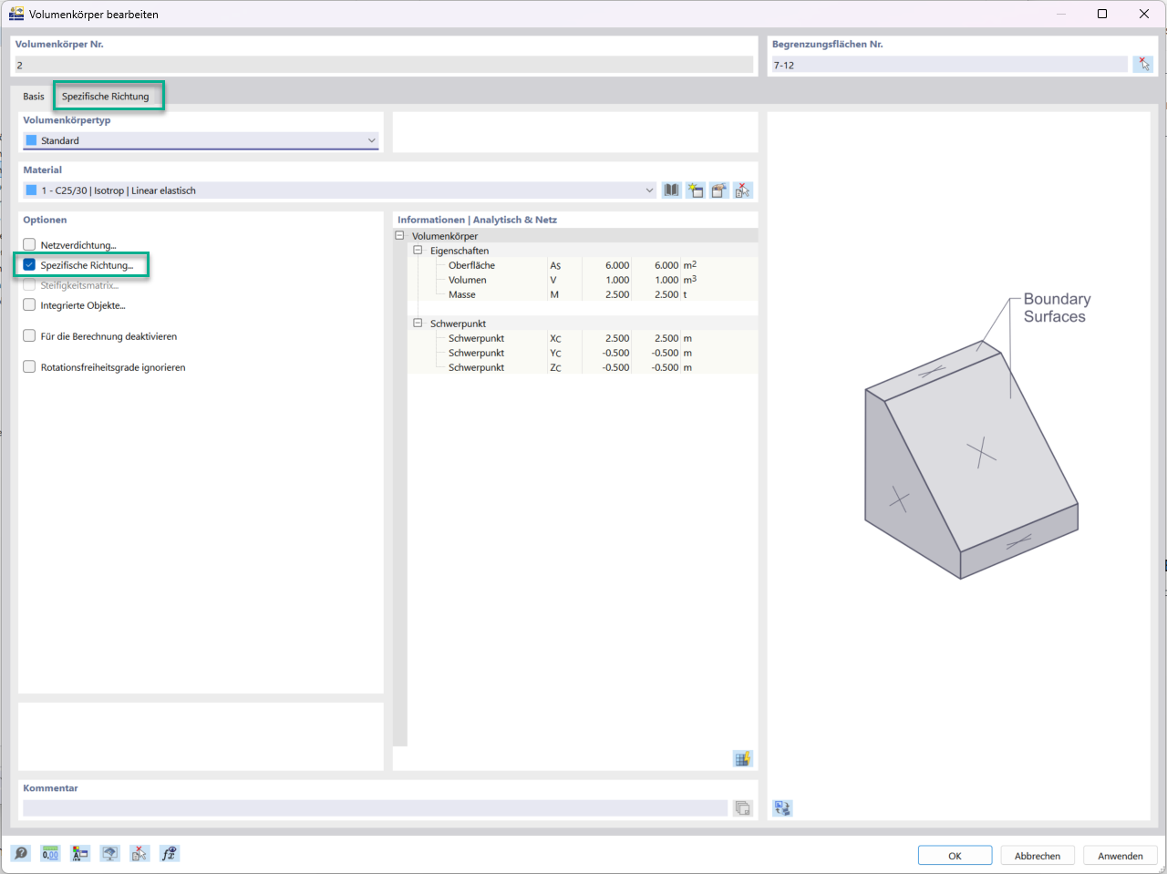

If no further settings are made, the results refer to the global coordinate system. However, you can modify the reference system. This can be done via the option “Specific Directions” in the volume editing:
The following FAQ explains this in more detail:
https://www.dlubal.com/de/support-und-schulungen/support/faq/005803
