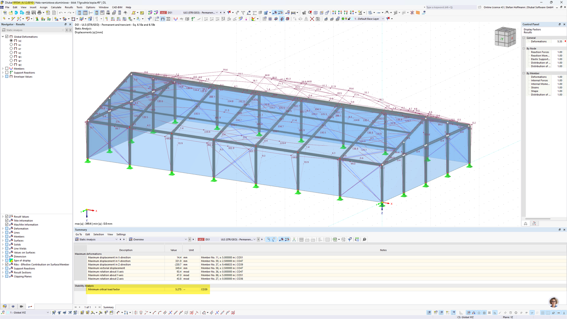

Good morning, I just downloaded the latest version of the program, went to Ultimate Limit State (ULS), clicked calculate, but I can already see that at least one combination shows an error. I am sending a screenshot.
