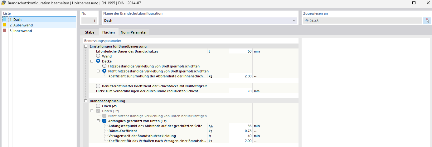

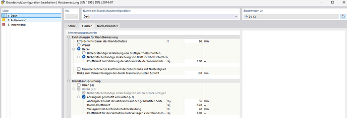

I am currently working on my term paper and want to consider the BS fire case for a roof structure made of flat cross-laminated timber elements. Due to different constructions regarding the roof and wall, I have different fire protection configurations.

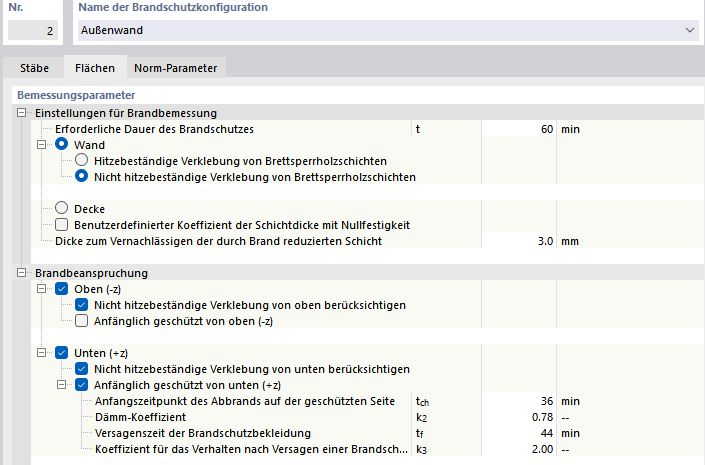

I mistakenly first set the walls in the fire protection configuration to ceiling level, and the project ran.
Afterwards, I noticed the setting error and changed it to walls. Since then, the model no longer runs. I have already watched the "Webinar | Fire Design in Timber Construction with RFEM 6," where this problem is also mentioned.
However, I do not know how to fix it.

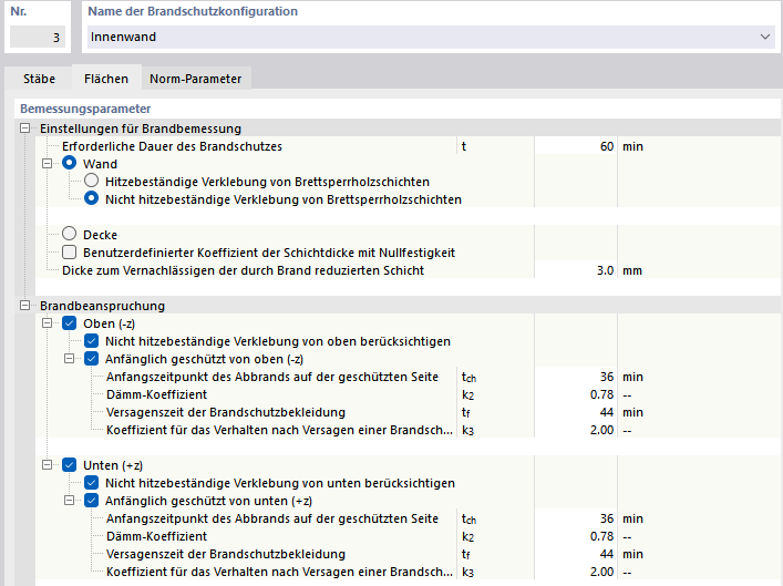

I use a single-layer 18mm fire protection cladding on all components. For the interior walls, fire protection cladding is applied on both sides.

Sorry, I found the problem. My 90mm inner wall is not sufficient for 1x18mm per wall side, so the system would fail and deformations of ten thousand mm would occur. Thanks anyway :slight_smile:
