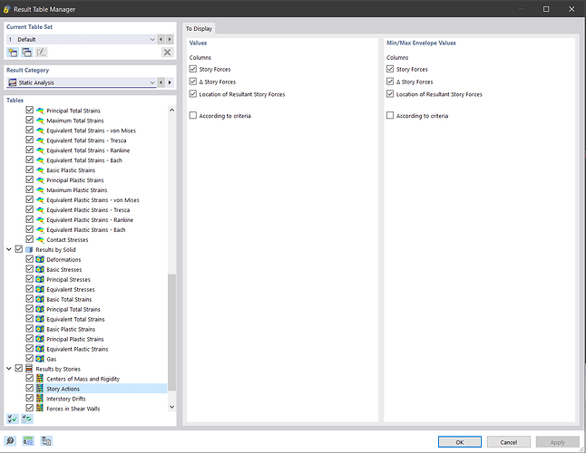

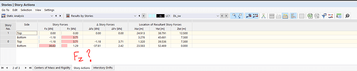

I need the Fz component of the story actions in the section ‘results by stories’ created by the building model add-on.
I looked into the settings of the table, but no options enable the reporting of this value.
How can I get the Fz component of the story actions?

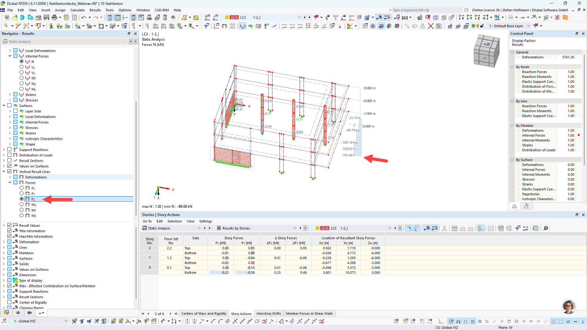

:white_check_mark: Recommended Workaround
In the meantime, you can use the result line values as an alternative:
:link: Result Line Values – RFEM 6 Online Manual
