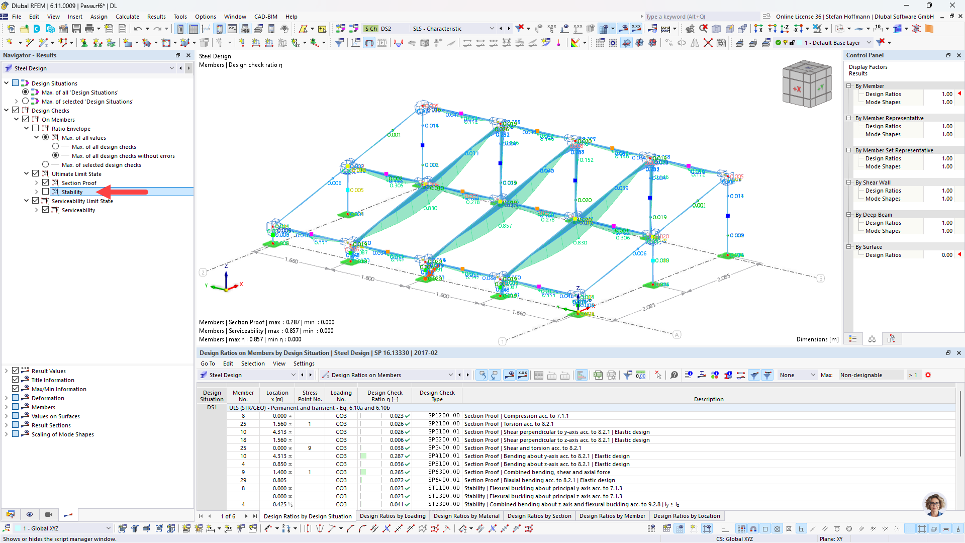

Hello.
This function doesn't work when calculating steel structures according to SP 16.13330 :(

Hi Сергей,
Thank you for providing the file!
I’ve reviewed the results of the design check and it looks like this might be a bug in the program. I've forwarded the issue to our development team for further analysis :hammer_and_wrench:
In the meantime, you can manually disable the stability design check ratios if needed:
:warning: Important recommendation:
It's generally a good idea to review and address the warnings/messages in the detailed design checks. Optimizing these can help ensure the overall stability and correctness of your model.
You can find more guidance in our online manual here:
:blue_book: RFEM 6 - Steel Design | Detail Check Warnings
Let us know if you have any further questions — we’re happy to help!

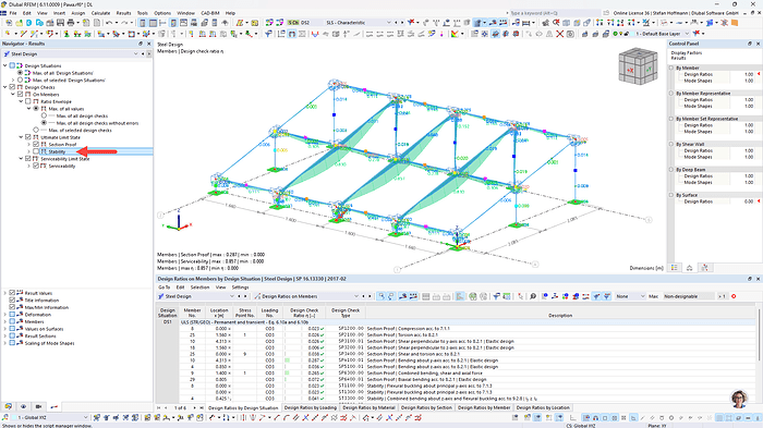

Hi Сергей,
Thank you for your patience! :folded_hands:
I’ve followed up on this, and I can confirm that the program behavior is intended in this case. Here's a bit more detail to clarify:
  • The handling of design check errors (e.g. of type ERxxxx) is different from the handling of regular design checks.
  • In your case, the messages refer to stability design checks (ST3100, ST3500) that ended unexpectedly.
  • These unexpectedly ending design checks are not classified as error design checks, but rather as standard design checks where, for some reason, the design ratio could not be determined.
Because such situations should ideally be corrected by the user, the messages are still shown under the corresponding result type, even though they are not considered formal "errors" in the same sense as ERxxxx.
If you have any further questions or need help interpreting a specific message, feel free to share more details — we’re happy to help! :blush:
If you look at the calculated stability check (ST3100.00; ST3500.01; ST3500.03) for the beams where there is an error, it is not entirely clear why RFEM6, with the given relative eccentricity mef>20, tries to perform the check as for a compressed-bent element according to section 9 (SP16.13330)? In paragraph 9.2.2 (SP16.13330), the last sentence states: "For values of mef>20, the calculation should be performed as for bending elements (section 8)." As a result, we get the error: "Local stability of the flanges of a compressed-bent element does not meet the conditions of 9.4.7." Or am I missing something?
