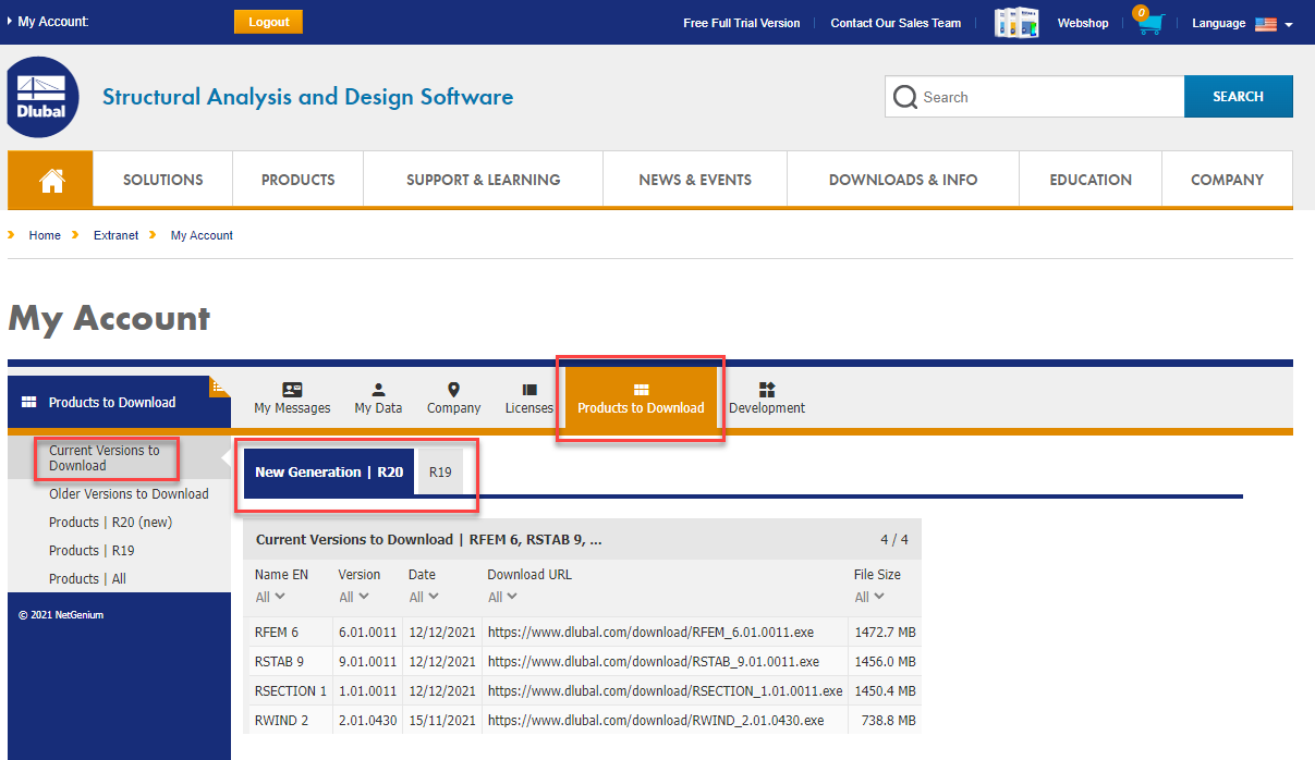

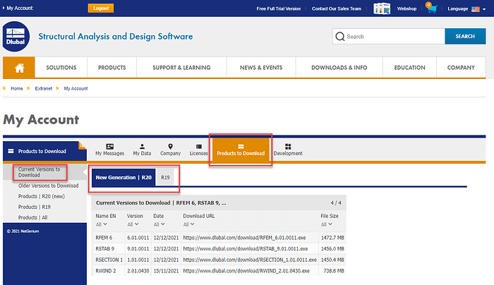

The mentioned BUG is supposed to be fixed in the latest version. Please download it:
