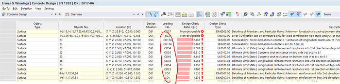

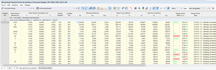

I don’t see any option in the results table that allows me to see the concrete design results for a specific load combination, as in the image below. Could you be more specific how to do this?

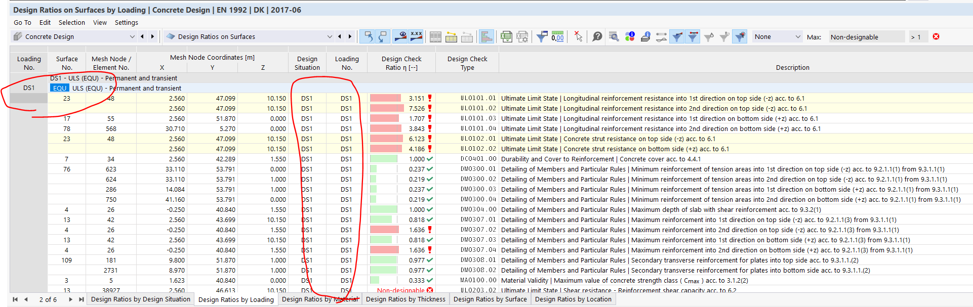

Even in the tab called ‘design ratio by loading’, still every results is given based on design situation, not combinations.
Hi PSA001,
Thanks for your follow-up! :blush:
Could you please check whether the verification method is set to "Enumeration Method"?
:link: Learn more in our Online Manual
:pushpin: What is the Enumeration Method?
The Enumeration Method calculates each load combination individually within a design situation.
This typically results in more accurate results, but it may also increase the calculation time.

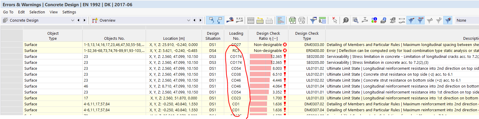

yes, after changing that setting, now the combination numbers are shown. Thanks.
