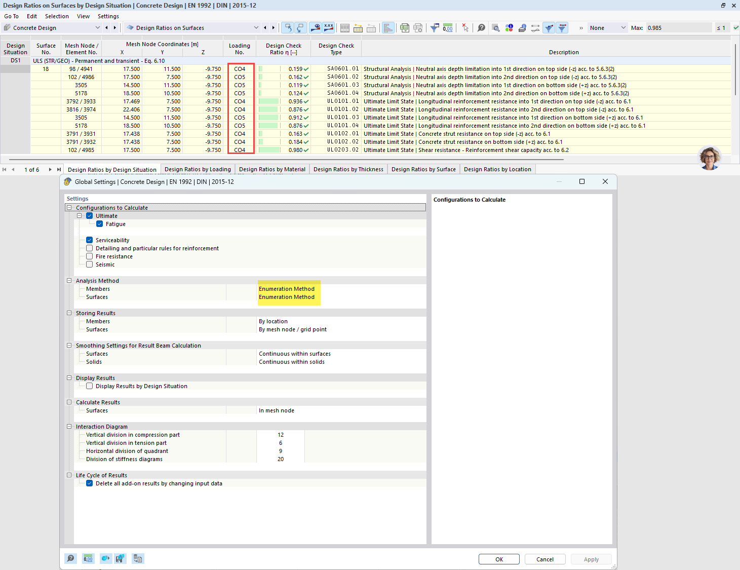

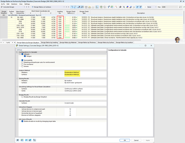

Could you please check whether the verification method is set to "Enumeration Method"?
:link: Learn more in our Online Manual
:pushpin: What is the Enumeration Method?
The Enumeration Method calculates each load combination individually within a design situation.
This typically results in more accurate results, but it may also increase the calculation time.
