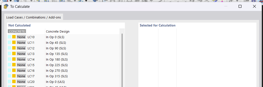

It ran fine, but I can't figure out how to add calculate the concrete design to this?
In ObjectId — Dlubal API documentation
all the concrete design seems to relate to setup rather than calculating it.

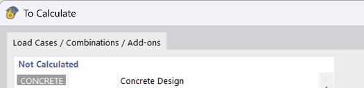

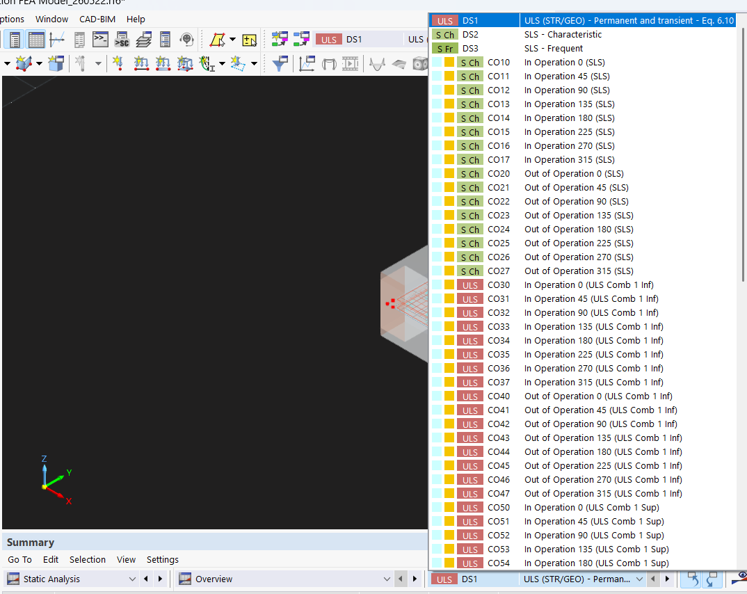

But my code failed to get the concrete design results. When I look in the UI of RFEM6
under Concrete Design there is no results
But all other static results for the two design situations I added to calculate_specific worked (ie contact stress for the surface for DS1).
When I go to the To Calculate under Not Calculated it has Concrete Design.
When I calculate this manually the concrete results show up.
I though your workaround should work as in the Design Situations Concrete Design Add on Is Checked, but alas it didn't.
Thanks!

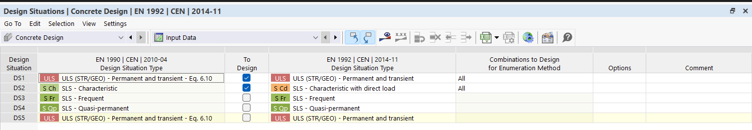

Hi Samuel,
I wanted to share an exciting update with you! :tada:

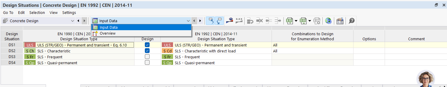

Starting from version 6.12.0003 | 2.12.3, you can now control which design add-ons are active for calculation within a Design Situation. Below is a simple code snippet to demonstrate how you can achieve this:
# Define the Design Situation object
design_situation: rfem.loading.DesignSituation = rfem_app.get_object(
    rfem.loading.DesignSituation(no=1)
# Disable the calculation for steel joints in the Design Situation
design_situation.active_for_steel_joints = False
# Update the Design Situation object
rfem_app.update_object(design_situation)
Let me know if you need further clarification or help with implementation. :blush:

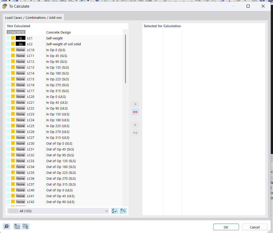

When I have calculate_all = True, I have no errors.

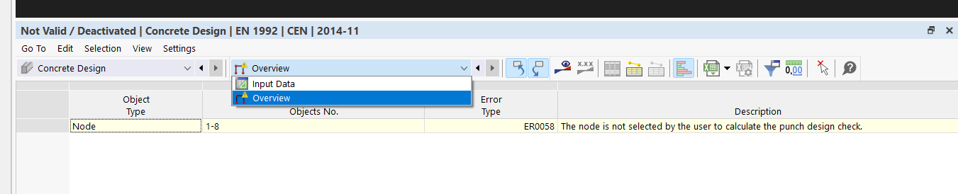

When I set it to False (ie I want to exclude primary load cases because they are unstable and slow caclulation time) I get an error at this line:
            concrete_design_checks_df = rfem_app.get_results(
                results_type=rfem.results.CONCRETE_DESIGN_SURFACES_DESIGN_RATIOS
            ).data
When I go into the model and select To Calculate everything I wanted to calculate was calculated, except Concrete Design.
So the code you gave above I suppose checks the To Design but it still doesn’t calculate Concrete Design so you can’t access the results in the API?
Am I understanding this correctly or is there a way to get that Concrete Design to calculate via the design situations and I am just coding wrong?

Hi Tomas,
I am still not getting this to work. Now I am working with a soil massif rather than having a surface support for my concrete slab, so for my unstable primary load cases (it relies on the self weight of the concrete surface for stability) the calculation for the primary load cases just won’t solve. So I really need to rely on the calculate specific to avoid running the primary load cases that are unstable. The calculate specific runs, but it doesn’t do the concrete design. When I click on to calculate in the RFEM6 ui afterwards, it shows the concrete design and the load cases I have excluded (even though my code specifies having concrete design as True for the design situations).
My code is
def _run_selective_calculation(
    rfem_app,
    design_situations: List[int]
) -> None:
    """Run selective calculation for specific load combinations.
    Calculates only:
    - Load combinations: 10–17, 20–27, 30–37, 40–47
    - Design situations for concrete design
    Falls back to calculate_all if selective calculation is not available.
    # Build list of ObjectId for the required load combinations only
    loading = []
    # Add load combinations: 10–17, 20–27, 30–37, 40–47
    for rng in [(10, 17), (20, 27), (30, 37), (40, 47)]:
        loading.extend([
            rfem.ObjectId(no=i, object_type=rfem.OBJECT_TYPE_LOAD_COMBINATION)
            for i in range(rng[0], rng[1] + 1)
    # Enable concrete design for specified design situations
    for ds_no in design_situations:
        _enable_concrete_design_for_situation(rfem_app, ds_no)
    # Try selective calculation
    try:
        rfem_app.calculate_specific(
            loadings=loading,
            skip_warnings=True
        logger.info("Selective calculation completed")
    except AttributeError:
        logger.warning("Selective-calculation API not available – running full model")
        rfem_app.calculate_all(skip_warnings=True)
    except Exception as e:
        logger.warning("Selective calculation failed (%s). Falling back to calculate_all.", e)
def _enable_concrete_design_for_situation(rfem_app, ds_no: int) -> None:
    """Enable concrete design for a design situation.
    Args:
        rfem_app: RFEM application context
        ds_no: Design situation number
    try:
        design_situation = rfem_app.get_object(
            rfem.loading.DesignSituation(no=ds_no)
        design_situation.active_for_concrete_design = True
        logger.info("Enabled concrete design for Design Situation %d", ds_no)
    except Exception:
        logger.exception("Failed to enable concrete design for Design Situation %d", ds_no)

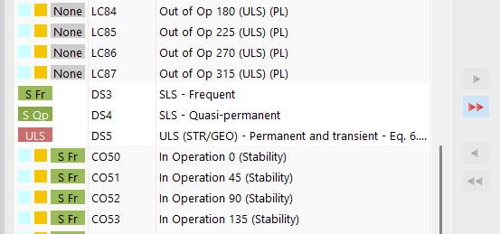

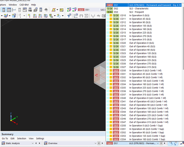

And below it shows that there is no concrete design results.
DS1 and DS2 are not there showing they have been calculated, but concrete design is there showing it hasn’t been run.
Is there something I am doing wrong?

Following on from this thread, I'd like to ask for an update on controlling what gets calculated via the Python API, specifically getting concrete design to run with calculate_specific.
What I'm doing:
  1. Flip the active_for_concrete_design flag on the relevant Design Situations and push them back to the model:
all_situations = rfem_app.get_object_list(objs=[rfem.loading.DesignSituation()])
to_update = []
for situation in all_situations:
    if situation.no in requested:           # e.g. {1, 2}
        to_update.append(situation)
rfem_app.update_object_list(objs=to_update)
  1. Build a list of ObjectIds for both the Load Combinations and the Design Situations and call calculate_specific:
loading = []
# Load Combinations across DS 1 & 2 (80 COs)
for i in lc_numbers:
    loading.append(
# Also include the Design Situations themselves
for ds in [1, 2]:
    loading.append(
        rfem.ObjectId(no=ds, object_type=rfem.OBJECT_TYPE_DESIGN_SITUATION)
result = rfem_app.calculate_specific(loadings=loading, skip_warnings=True)
# result.succeeded == True, result.message == ''
What I observe:
  • All 80 Load Combinations show as calculated in the RFEM GUI (static analysis table overview lists them)
  • Concrete design has not been run. The reinforcement results are empty in the model, and pulling rebar diameters back via the API returns NaN:
File ".../reinforcement_results.py", line 123, in extract_calculated_reinforcement_results
    main_dia = round(m_to_mm(m=sr.rebar_diameter))
ValueError: cannot convert float NaN to integer
If I disconnect from the API, open RFEM, and hit Calculate manually, concrete design runs correctly and the reinforcement results populate. So the Design Situations themselves are configured correctly (active_for_concrete_design = True is persisting) and there is no error in concrete design blocking it, calculate_specific just doesn't appear to trigger the concrete design step the way the GUI Calculate (or calculate_all) does, even when the Design Situations are included in the loadings list.
For reference the reason I can’t use calculate all is that some of my load cases are unstable and thus take a long time to compute / fail, only in the load combinations does it run.
My ask:
Is it possible to run concrete design via calculate_specific at all? If so, what am I doing wrong in the snippets above? If not, when can I expect this functionality to be added — I've been asking for this for quite a while, and without it a fully automated API-driven workflow isn't achievable.
Version: 6.14.0006
Thanks,
Samuel
Quick update in case anyone else had the same issue: I found a workaround, tested on RFEM 6.16.0001. I untick To Solve on the unstable load cases (which take a long time to solve before failing), then call calculate_all(). It skips them, still solves all the combinations, and runs concrete design. The design situations stay active with active_for_concrete_design = True, and concrete design runs on them from the solved combinations.
load_cases = rfem_app.get_object_list(objs=[rfem.loading.LoadCase()])
for lc in load_cases:
    lc.to_solve = lc.no in load_cases_to_keep
rfem_app.update_object_list(objs=load_cases)
So this is a good alternative to calculate specific which doesn't seem to allow running add-ons.
