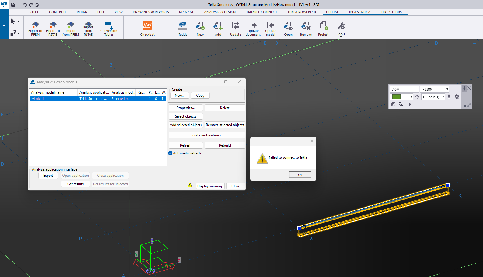

I'm currently trying to convert a tekla model to RFEM6 however the converter is returning the error:
I have RFEM6 opened and i just reinstalled the Tekla conversion tool.
Any idea about what may cause this?

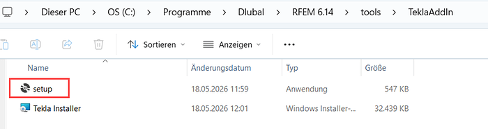

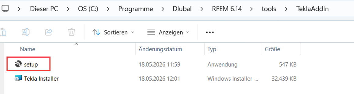

The Plugin is not updated automatically when a new RFEM Version is installed. Please reinstall and update the plugin as follows:

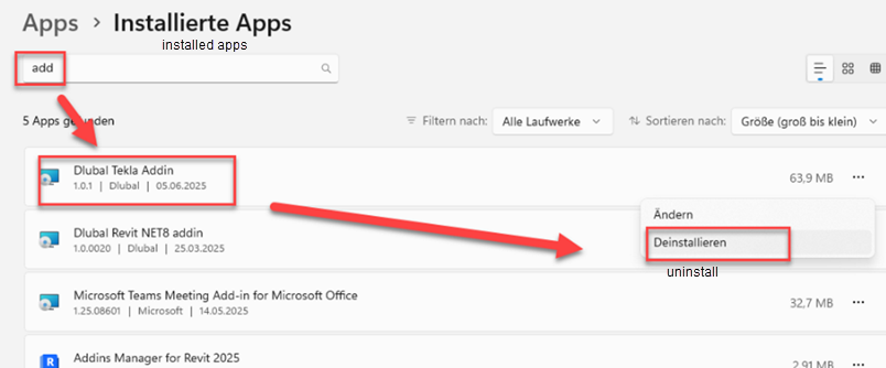

Uninstall the Tekla plugin (via Windows Settings - Apps)
Install the latest add-in for your RFEM version

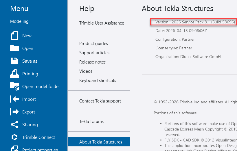

Also give me the information about your installed RFEM version.
