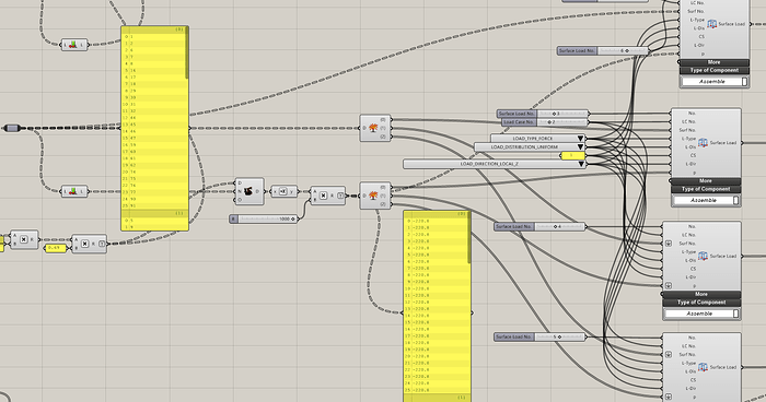

Hi all,
From my experience in experimenting with the surface load component(i have not tried other load components for this project yet) it appears that it cannot take data tree inputs for loads as it will only apply the first tree(both trees share the same number of items, branches and path names). My organisation after flattinging still holds and even for this list, matching surfaces with different loads does not appear to correspond as it picks the highest load value.
Am i correct in this assumption or am i making a mistake somewhere?
I this is indeed correct, it would be an amazing quality of life function to allow for this interaction as it safe significant time and make the script more parametric.
I added the file in question for any others that might be interested.
Square quadrilateral grid.gh (151.9 KB)
This one was a far simpler fix than I thought, if the system has duplicate surface numbers in separate trees it appears to bug out and present the issue that is mentioned above.
