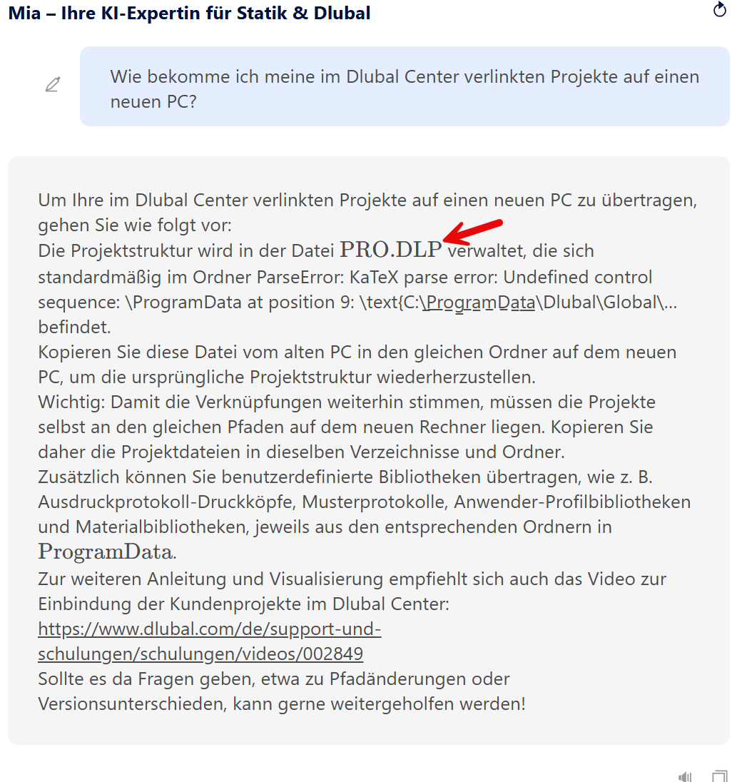

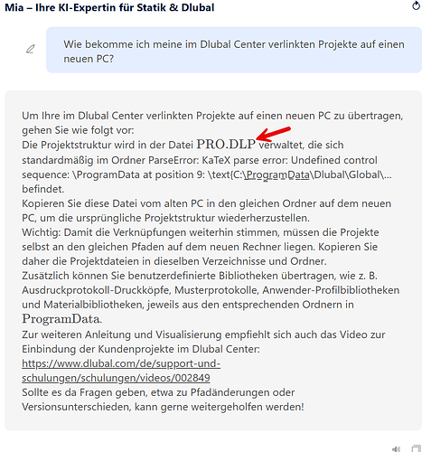

How do I transfer my project structure in the Dlubal Center from PC A to PC B? (Projects are located in directories/paths with the same names)
MIA recommended the Pro.DLP to me, but that refers to RFEM5 and RSTAB8?
