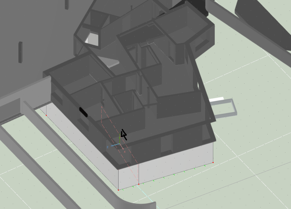

For example, once the first “IFC surfaces” have been converted into “RFEM surfaces,” it is often difficult to select the remaining IFC surfaces:
Here, for example, you would like to click on the “IFC ceiling,” but you constantly catch the walls of the basement or the basement slab. How great would it be if I could simply press the Tab key while keeping the mouse position constant and cycle through all options to choose which component to select?
