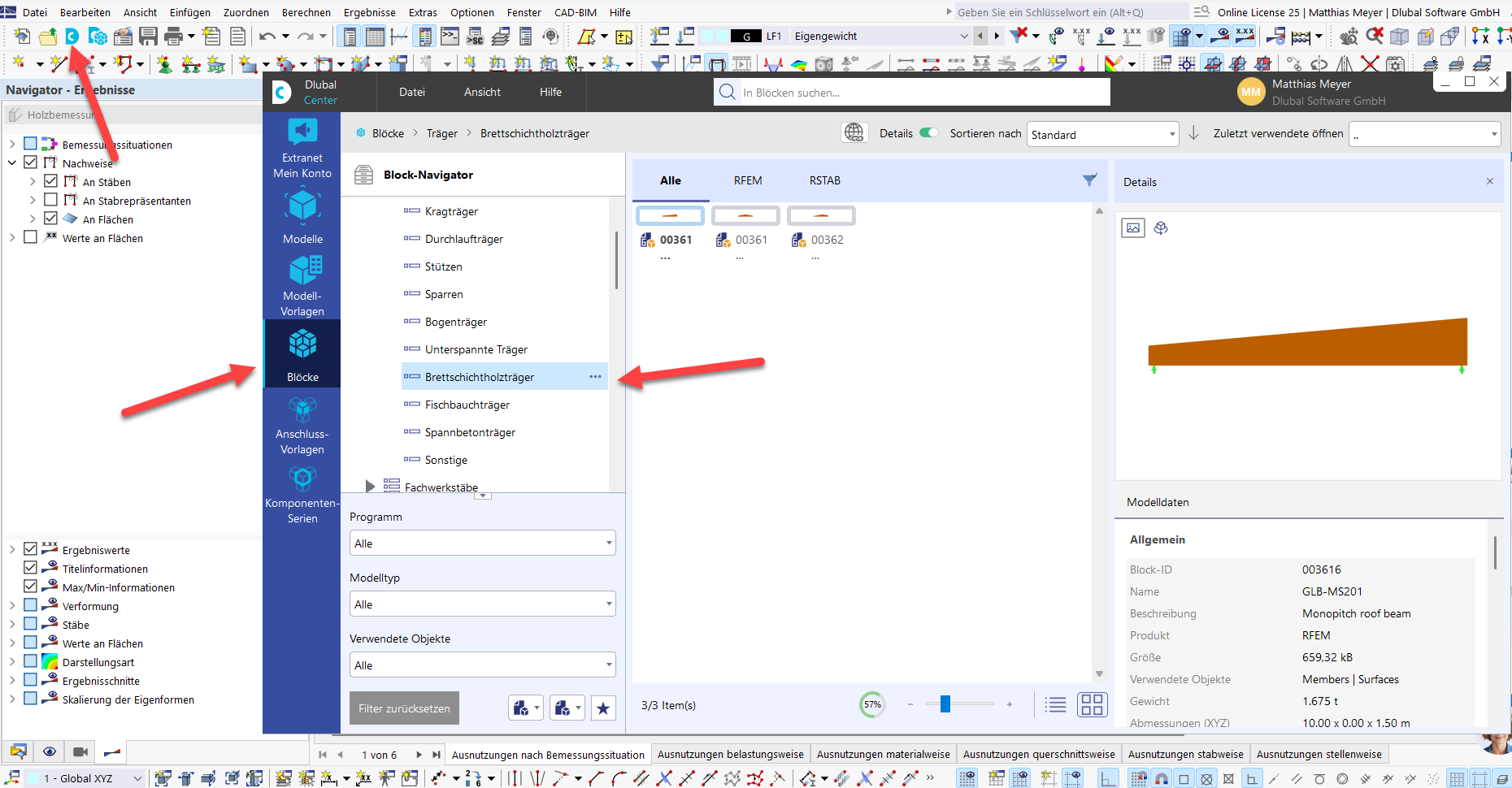

yes, you can insert a result bar into the surface. You can easily download a BSH beam with result bar as a block from the Dlubal Center. :inbox_tray:
Additionally, I would like to point you to the Knowledge Base article Bemessung von wandartigen Trägern in RFEM 6. It describes the use of the result bar in detail. :books:

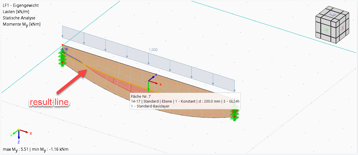

In this case, you can use a result line to obtain the inner forces of your beam. Here’s a step-by-step guide:
  1. Create your fish belly beam as a surface.
  2. Define an arc using 3 nodes along the center line of your surface.
  3. Define this arc as a result line.
  4. Finally, include the surface in the results of your result line.
Unfortunately, verifications for fish belly beams are not yet implemented. We understand this might be limiting, and we’re always working to improve the software. If you have any further questions or need additional help, feel free to reach out! :blush:
