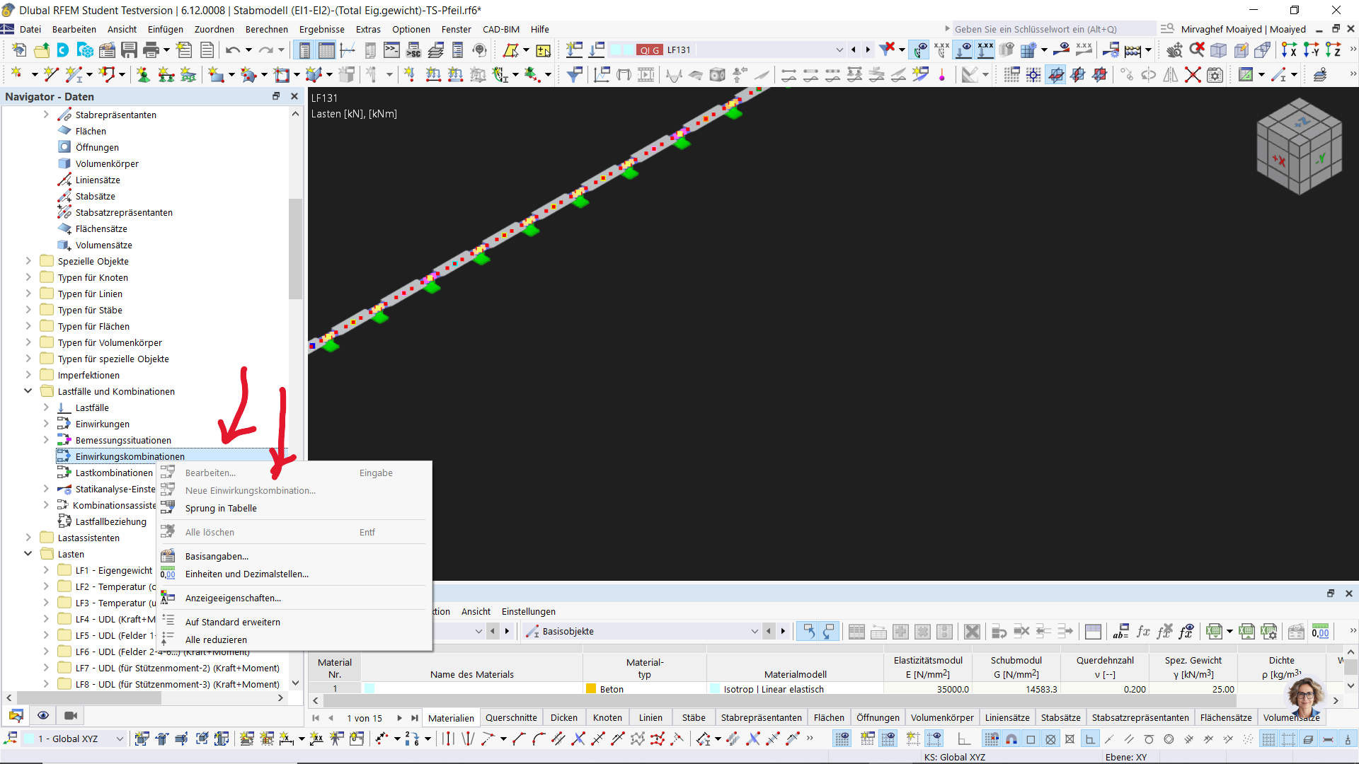

I am currently working with RFEM version 9.12.0008. However, in the Load Combinations section, the options "Edit" and "New Load Combination" are permanently inactive. The same problem also occurs in newly created models, so I am generally unable to use these functions. A screenshot is attached.
Screenshot
I would like to know what might be causing this.

To access this feature, you need to activate it first in the Combination Assistant.
Please refer to the following section in our online manual:
:backhand_index_pointing_right: https://www.dlubal.com/de/downloads-und-infos/dokumente/online-handbuecher/rfem-6/000256

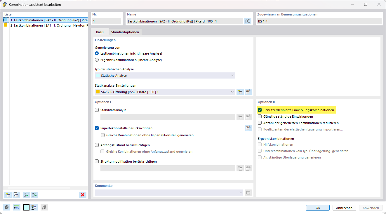

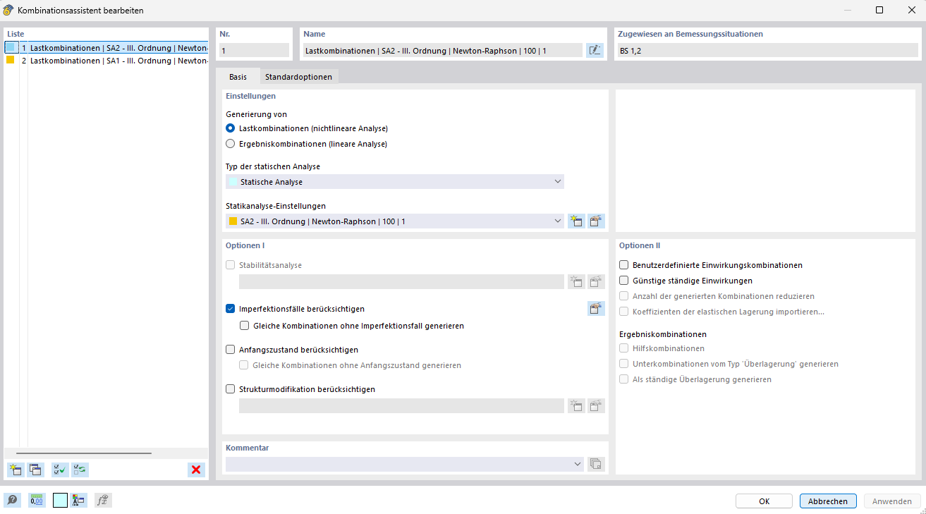

I have one more question about this. In my case, the option "Reduce number of generated combinations" is grayed out under Options II in the Combination Assistant. Why is that? Could it possibly be because I only purchased a trial version?

Hi fdoetsch,
Thank you for your message! The trial version has no restrictions here.

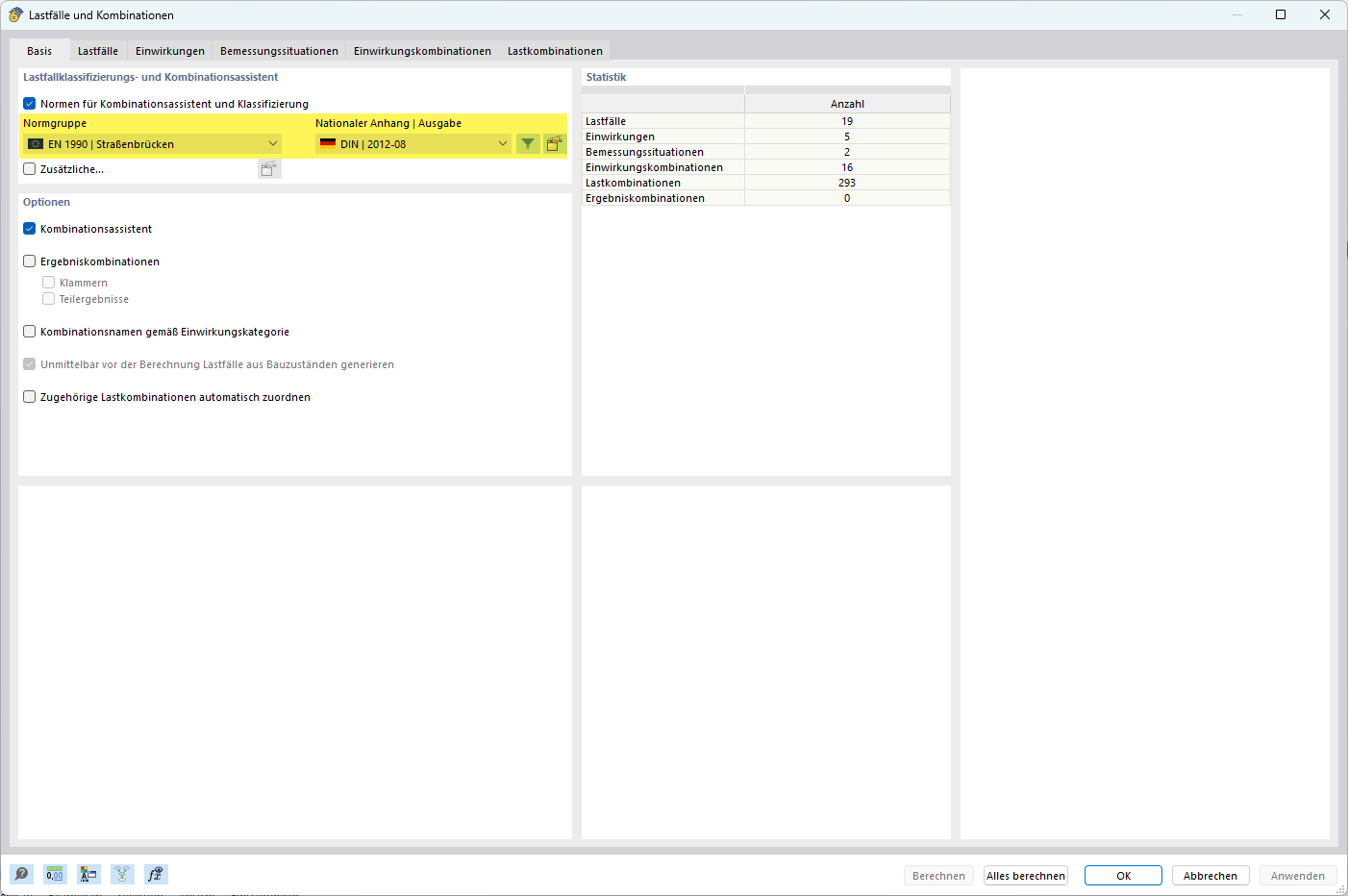

Hi Fabian,
Unfortunately, this option is not available for the standard group road bridges:
