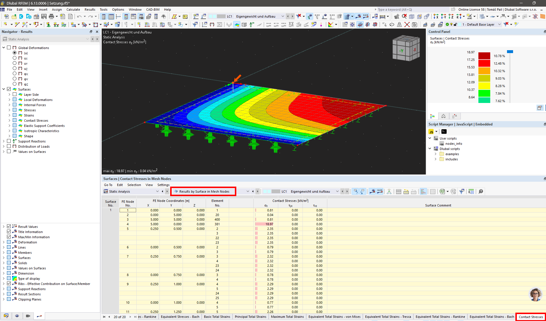

Also in this matter is there a table with Contact Stresses availabre in RFEM ? I coulnd find corresponding tab..

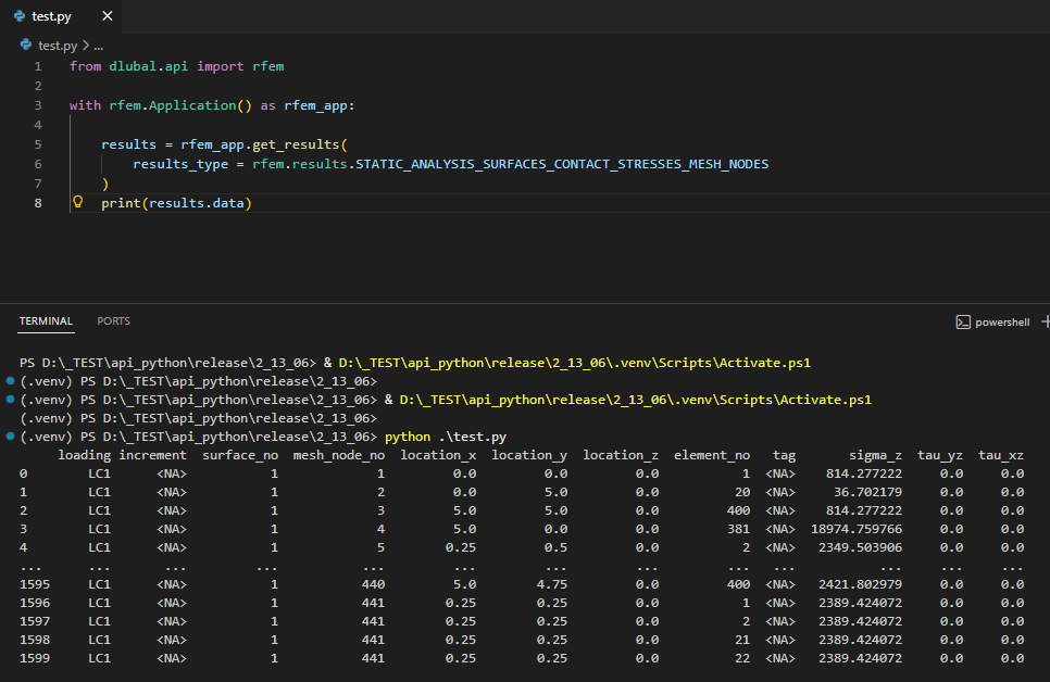

Hi r.sajdak,
I will check the API part later today, meanwhile here is where you can find it in RFEM (it’s been recently added for mesh nodes).
Regards
So also API seems working (see fig) so only check whether you have version of RFEM where this type of result is already available.
