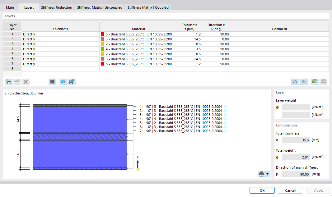

I’m using a multilayer thickness element with stiffness reduction activated at RFEM 6:
When all materials are linear, the calculation works normally, but when I use the ‘Nonlinear Material Behavior’ add-on and set one of the layers to use a material of type “Orthotropic | Plastic (Surfaces)” I get a calculation error:
If I deactivate the stiffness reduction when using the nonlinear material it also works, but I would like to use the nonlinear material and the stiffness reduction, is that possible?

Hello Pedro,
unfortunately, it is not possible to create plastic materials with a stiffness reduction of the layers.
To clarify this in the future, the error message has been adjusted accordingly.
