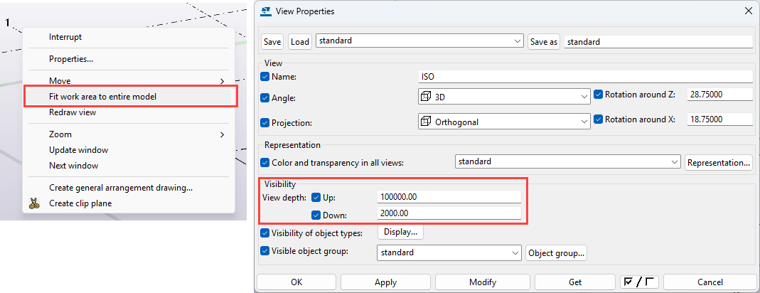

Sometimes the working area in Tekla is not updated automatically. Please check the visibility settings in Tekla after Import:
If the error still appears, please give me the information about your RFEM and Tekla Version you use. If possible, you can also share your Tekla model.
