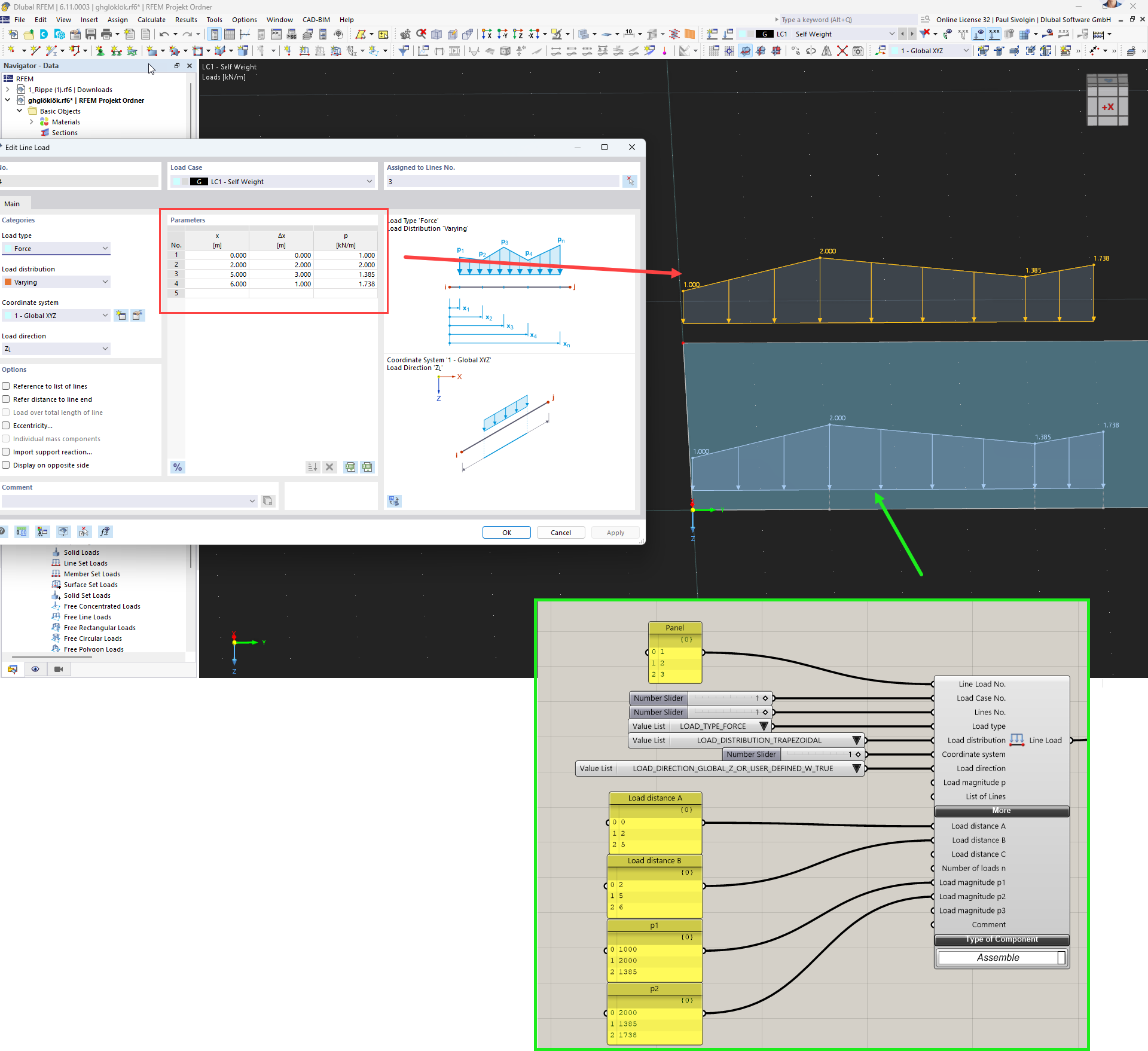

As a workaround, the line load of the type "trapezoidal" can also be used, where the load parameters are defined via lists.
I have attached a file that shows how this could be implemented as an example:
Varying Line Load.gh (29.8 KB)
