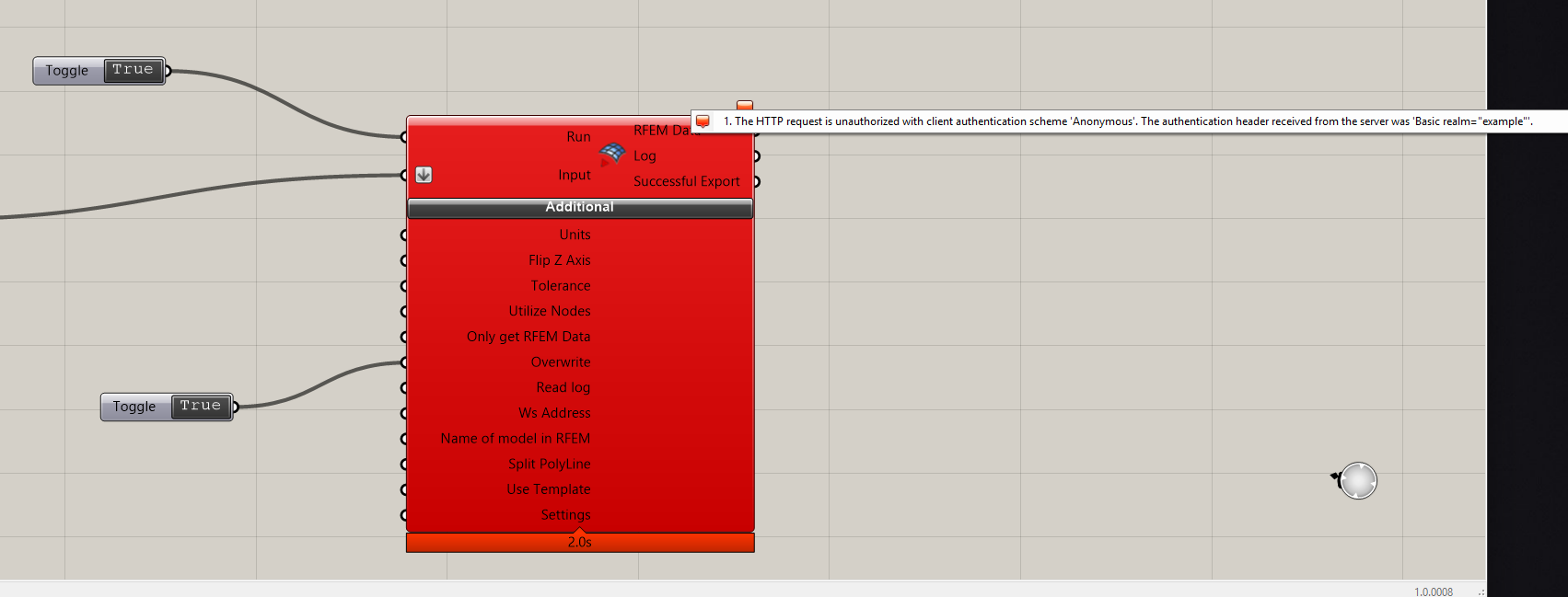

I have an issue with exporting my model from rhino 8, using grasshopper, to rfem 6 (6.10.0010 Student version) using dlubal plugin (8.609.10.2).
when i toggle "true" on export component i get a message "1. The HTTP request is unauthorized with client authentication scheme 'Anonymous'. The authentication header received from the server was 'Basic realm="example"'."

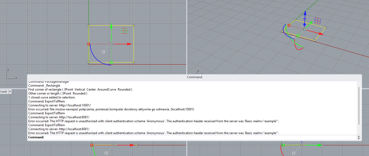

Im having the same error as the others. Rhino 8 Educational version, Dlubal plugin 8.612.12.1 and RFEM 6.14.0001. In the program settings, webservices are enabled.
When trying to export random geometry to RFEM such error occurs:
Command: ExportToRFEM
Connecting to server: http://localhost:8081/
Error occurred: The HTTP request is unauthorized with client authentication scheme 'Anonymous'. The authentication header received from the server was 'Basic realm="example"'.
I tried to change ports, but it didn't help.
I'd be grateful for help in resolving this problem.
Hi Bachrouch,
welcome to the community!
I fixed your connection issue, the API was not activated for whatever reasons. I activated it now, please give it a try.

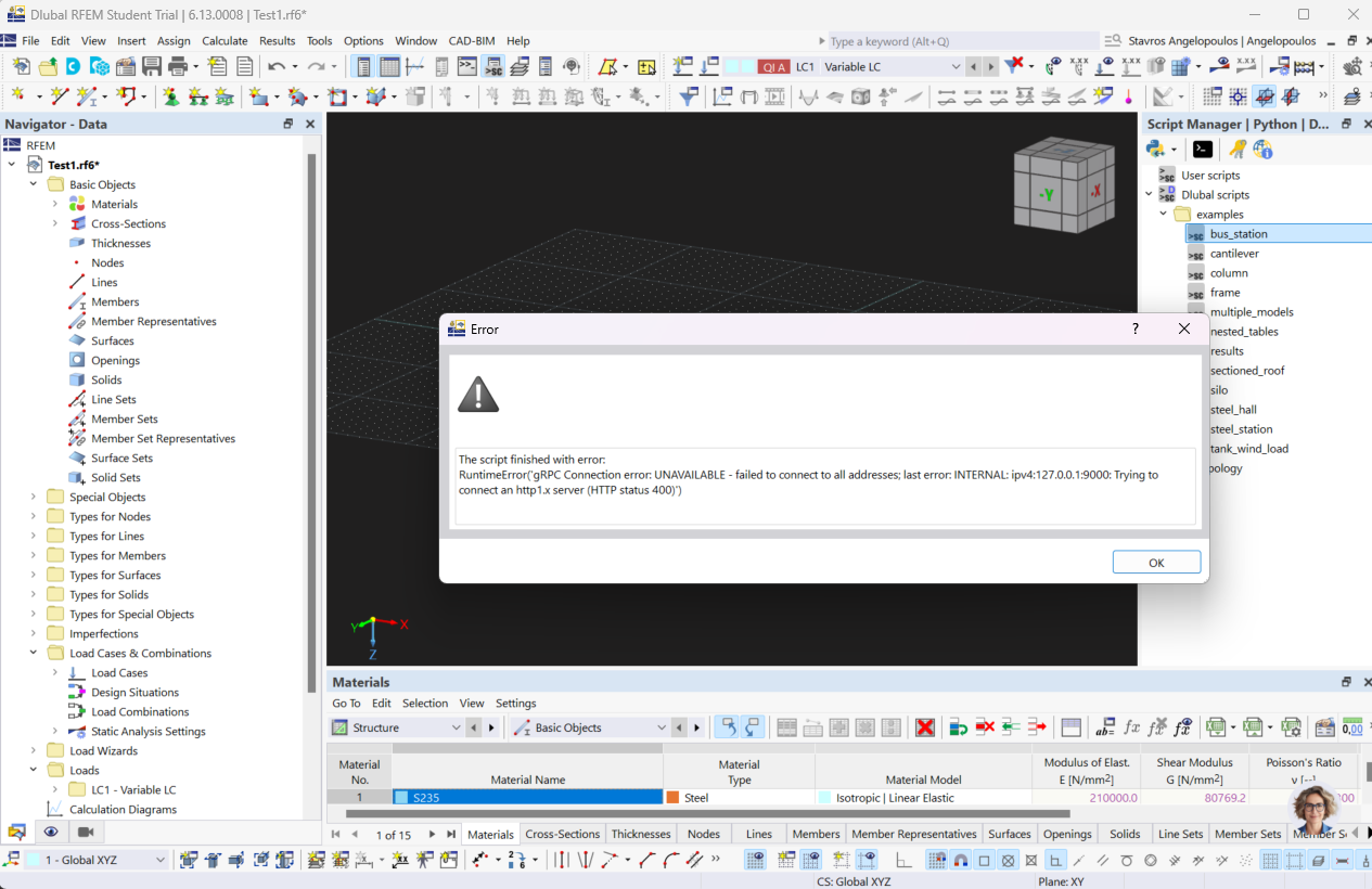

Hi I got te previous error as well as this error when I try to run the script. Can you please help me?
Hi Stavros,
please create a new topic for your problem, I checked the settings in our system at it seems that it has nothing to do with this topic here. Also it would be good to have more informations about your problems, that make life easier for us to support you.
