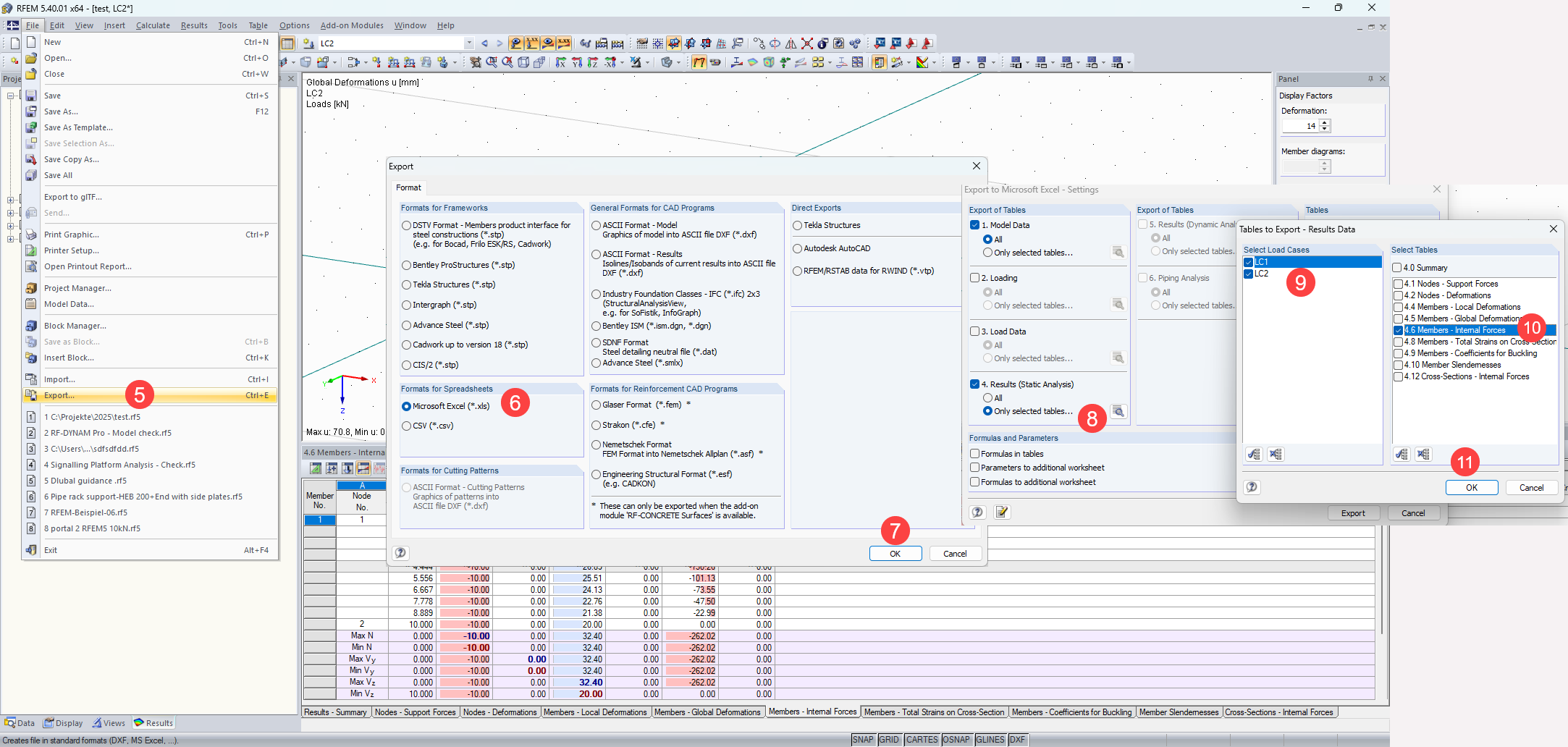

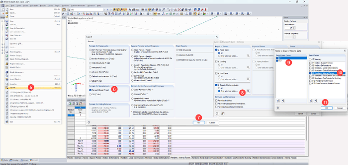

Usually you go into the inner forces of members table and export it:
Thank you very much, Stefan Hoffmann. I appreciate your attention.

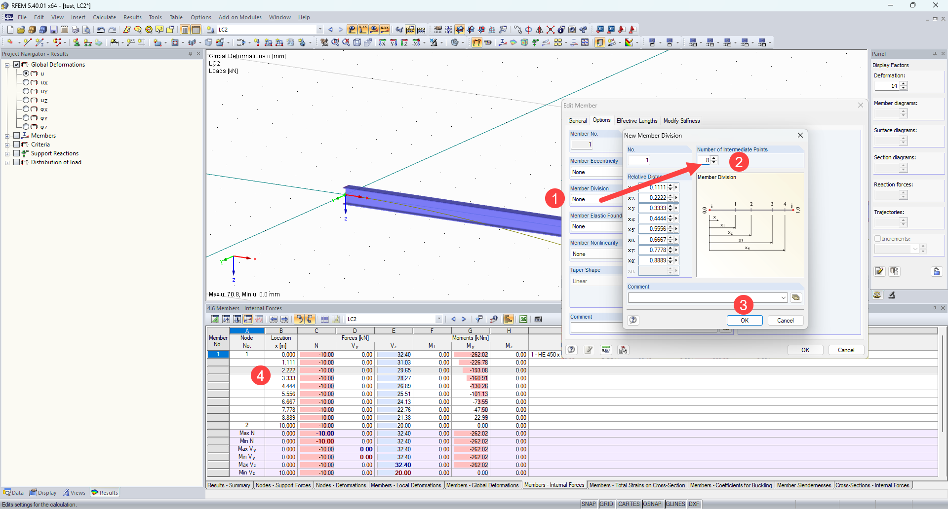

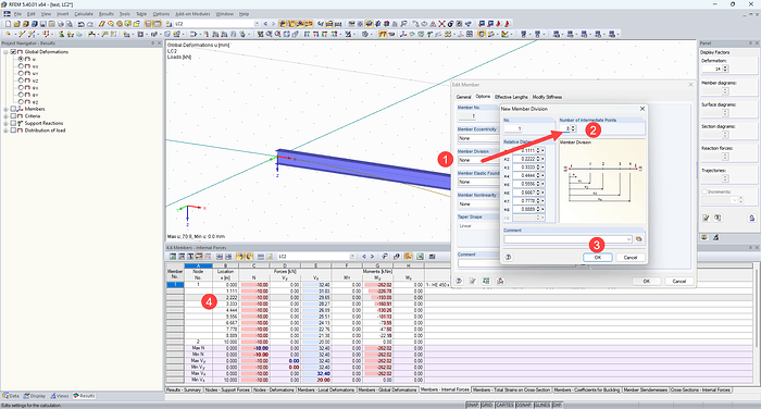

You can also display inner points of the member, if existent and export them:
Muchas gracias, una vez más. muy amable
