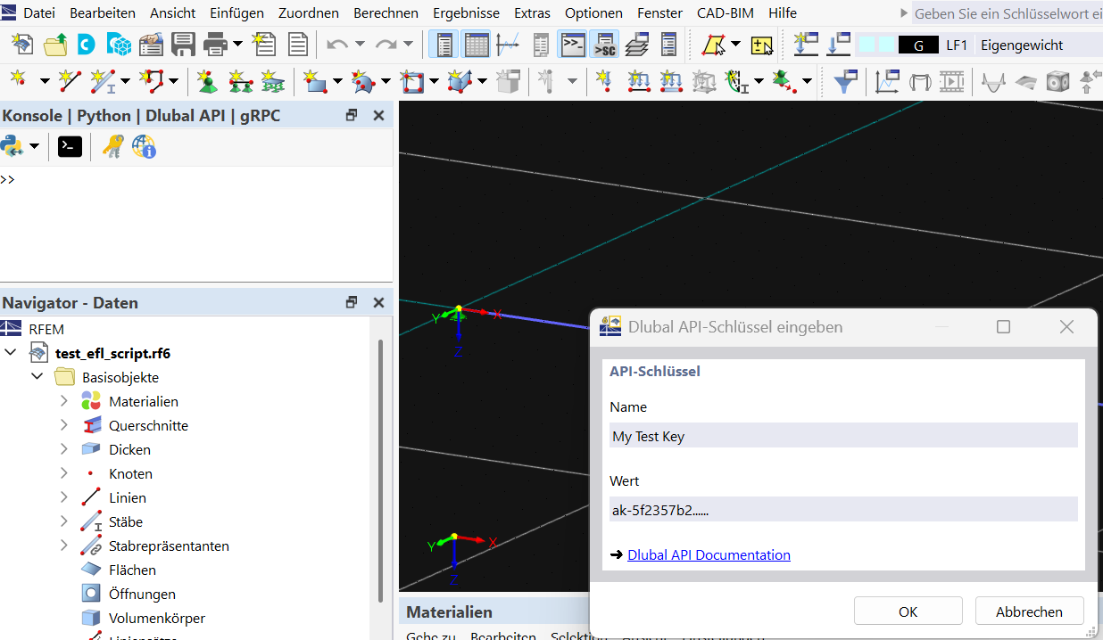

Hello Ms. Goebel,
thank you for the quick response. I am now logged in as an admin, but I still cannot activate the API key.
Here is how I proceeded:
  • Create API key
  • Open Python console
  • Enter Name: My test key
  • Enter Value: api-key
This is how the API key activation works for my colleague. I still receive the message "permission denied."
I cannot follow the instructions in the link you sent.
Is it possible for me to show you my problem via the shared screen?

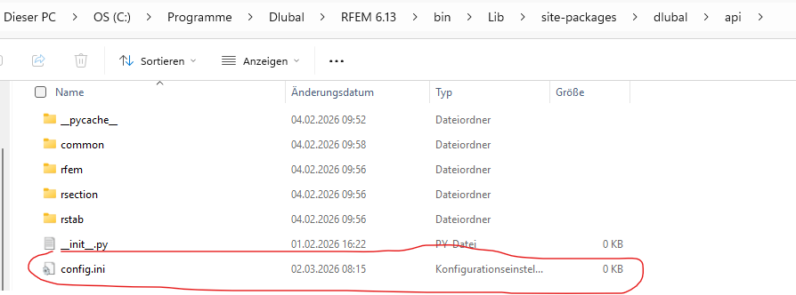

I also created the config.ini file you mentioned, copied the API key into it, and placed it as an admin in the corresponding folder:
Result again: "permission denied."

Hello @c.hausmann,
the message "Permission denied" always appears when RFEM/RSTAB is not started as an administrator, because then the config.ini cannot be accessed.
The message "...UNIMPLEMENTED" currently appears when no port is specified in the script and RFEM/RSTAB is not running on port 9000. In this case, the port must be specified in the script:
