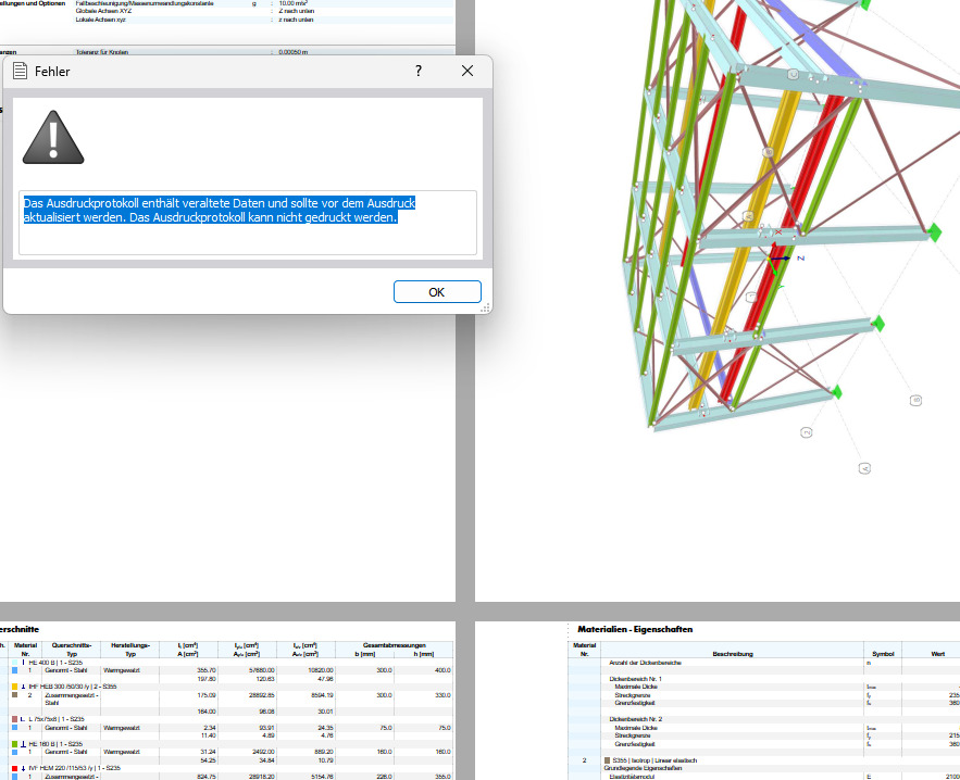

I am currently compiling a static analysis for which I create several individual print reports in RFEM and then print them as PDFs.
Unfortunately, with my second report, I always get the error message:
The print report contains outdated data and should be updated before printing. The print report cannot be printed.
Of course, I have already updated multiple times, restarted the file, and also tried with another copy of report 2, but unfortunately the same error occurs with the copy.
What else could I do to save the printout?
Restart already done, updated 10 times, copied print report → already done…
Problem just solved!
Not the most orthodox solution, but after removing the "basic information" in the protocol, it suddenly worked smoothly.
