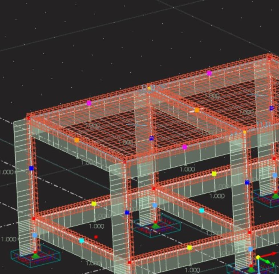

Further, I noticed even if I put single reinforcement net (bottom net) for the slab, it apparently doesn't even care the hogging moments at near the beams as slab is monolithically connected to the beam. It's not simply supported so it should be able to understand that I didn't put hogging reinforcement.
It seems like it will pass the reinforcement design even without checking those critical things.
Is there any way to put corner reinforcement and hogging reinforcement in addition to the reinforcement I have put as a surface? (I noticed I can put a top reinforcement net, but that would apply to the whole slab, I just want to add it to where the hogging moments will occur to make it bit economical)
And how to make the software check for things like missing corner reinforcement? and hogging reinforcement?
Is there any auto design feature to generate necessary reinforcement for the slab?

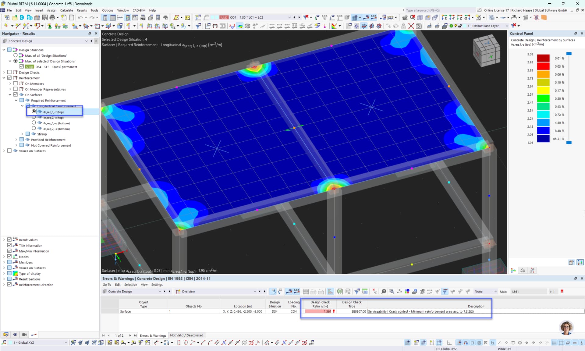

But at the time we have crack design checks which are fitting to the corner area.
Have a look on the attached image.
And the bending moments of the slabs looks good for me. The columns and the beams are monolithic connected with the slab so they influence each other.
But please show which forces you expect.

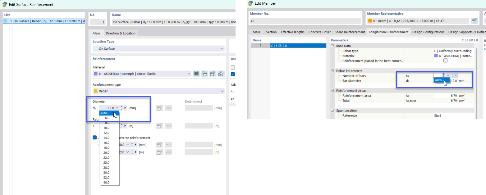

With our option "not covered reinforcement" you can check how much reinforcement is required to fulfill the design checks.
And yes you have the option to choose between "manual" and "automatic" reinforcement.
So you have the possibility with the automatic option to layout the reinforcement acc. to the governing results.
