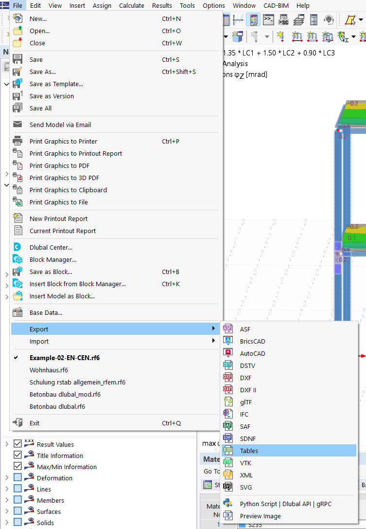

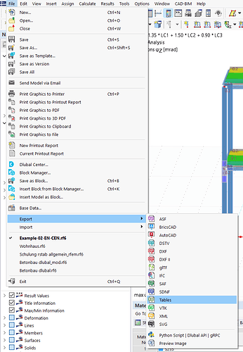

Unfortunately, there isn't a direct feature like that in the RFEM interface. However, you have two options for extracting the results:
  1. Export the result tables to Excel: This can be done through the main menu.
  2. Use the API service: This allows you to read results and process them in your own scripts.
For more detailed information on the API, please refer to the API documentation. It provides examples on how to extract results and work with them effectively.

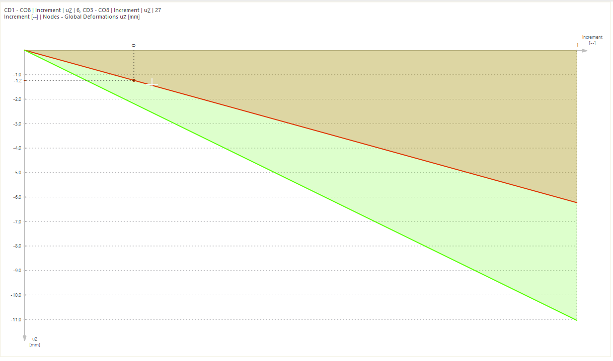

Thanks! That’s what I expected, but I wanted to make sure I wasn’t missing any functionality similar to formulas but applied to the results.
For a simple case like mine, I decided to use Calculation Diagrams to quickly view all the required values on one screen. It’s not ideal, but it works well enough without needing to dive into coding or use external interfaces.
