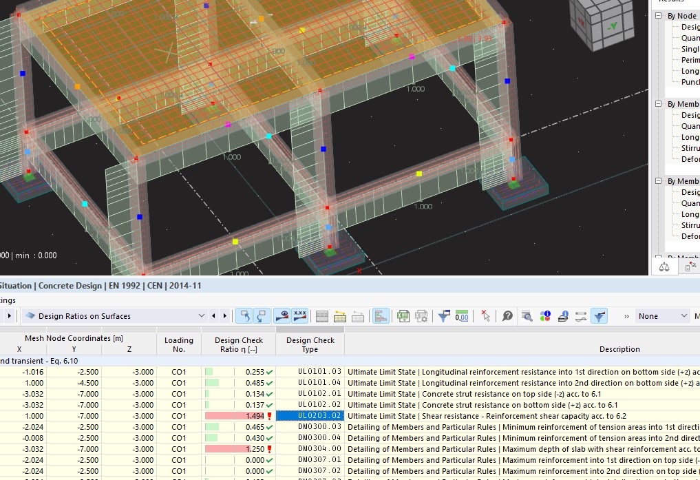

I drew the beams and on top of it I drew a plane surface using the select boundary.

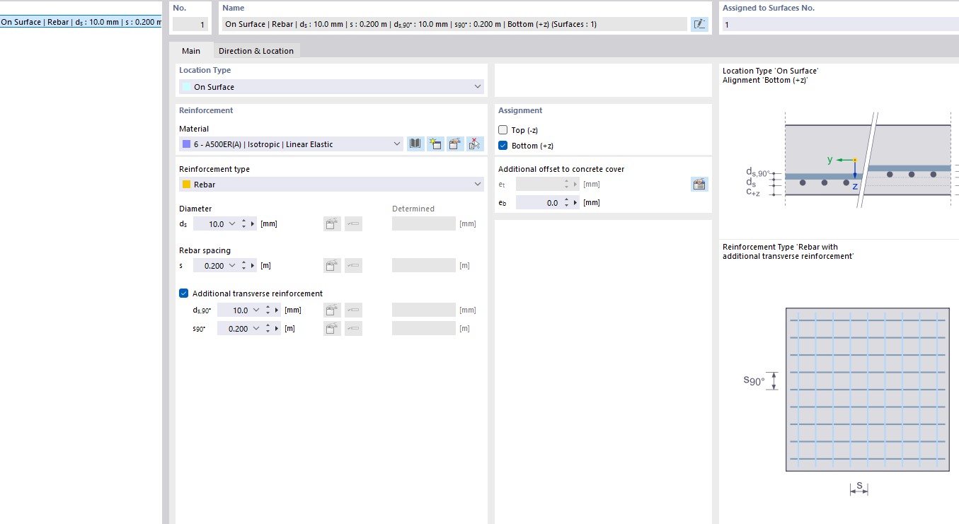

Then I set the reinforcement etc.
But it doesn't show a field to set the slab thickness.
Did I add the monolithic slab in a non-proper way?

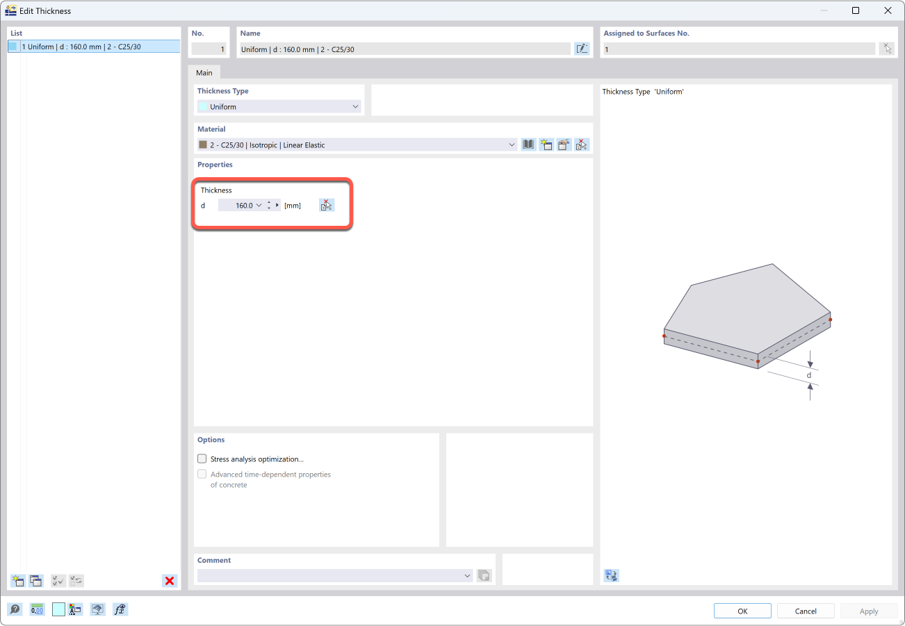

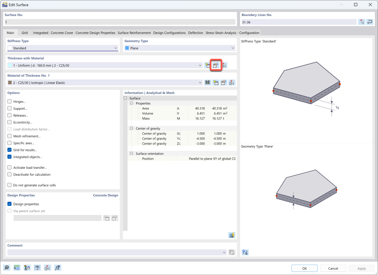

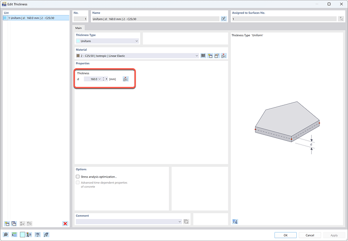

You can set the slab thickness here:
