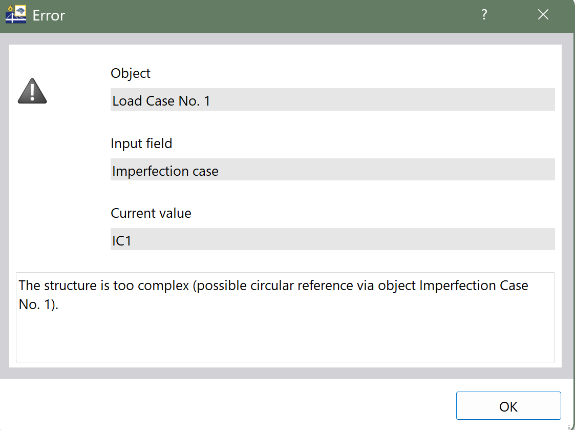

I am performing an nonlinear analysis of a laterally loaded pile using the RFEM 6 API for my thesis project. My goal is to incorporate nonlinear spring stiffness, second-order effects, and imperfections based on a buckling mode derived from either a load case or a load combination.
I am able to run the analysis successfully with nonlinear springs and second-order effects. However, when I include imperfections, I encounter the error shown in the attached image.

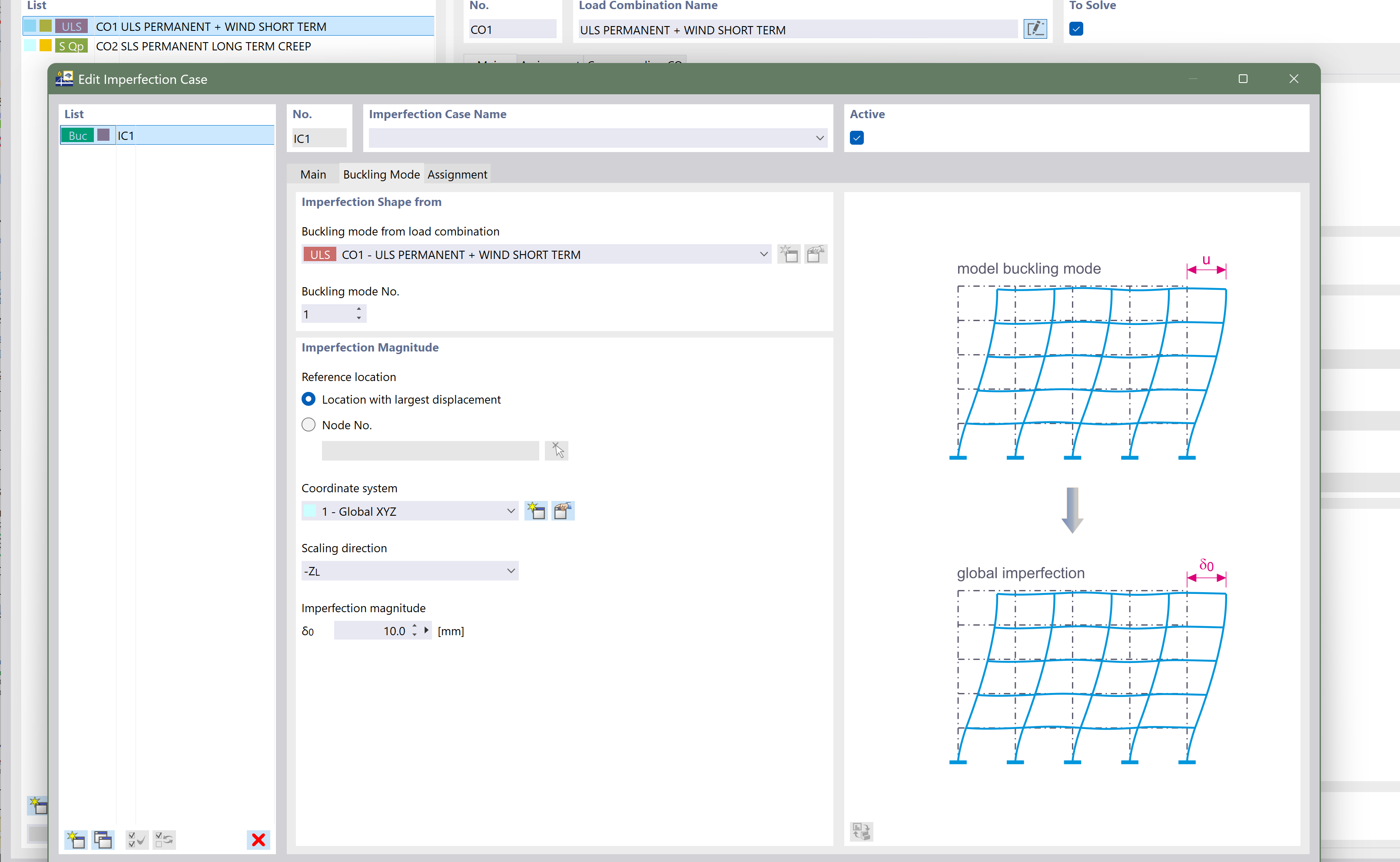

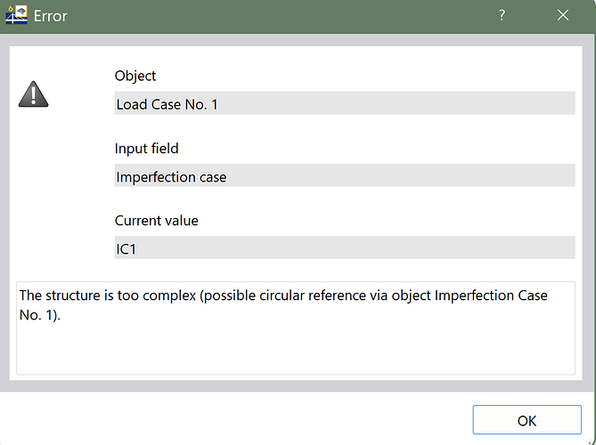

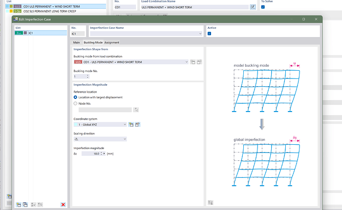

Im trying to apply the imperfection via load case or load combination. Once I press apply, I get this error.
I might had Stucture Stability Addon off in the model I sent. I have activated this addon.

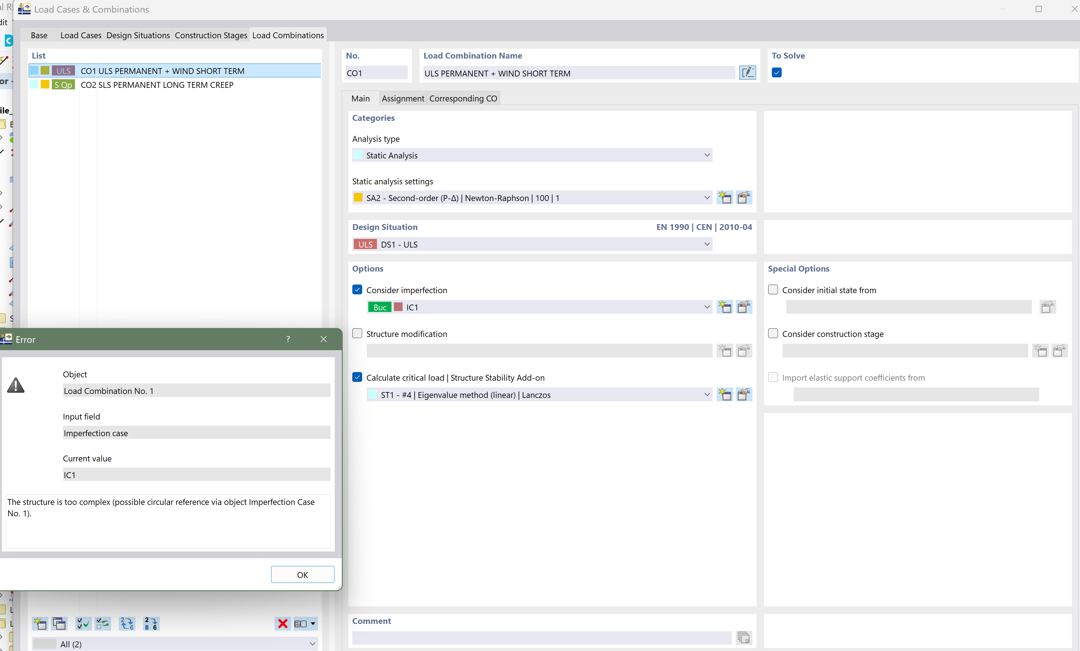

Hey, you said you have tried to switch up sources for the imperfection. But could you try to copy the load combo, in older versions (RFEM5) thats how it worked
co1 creates ic1, ic1 then used on copy of co1
Because the way u defined it in your last picture its co1 → ic1 → co1, this might cause the „circular“ error
Make sense, I have to create the buckling imperfection case with CO1 using the stability analysis, then run a copy of CO1 with the created imperfection. Now it works, thank you!
