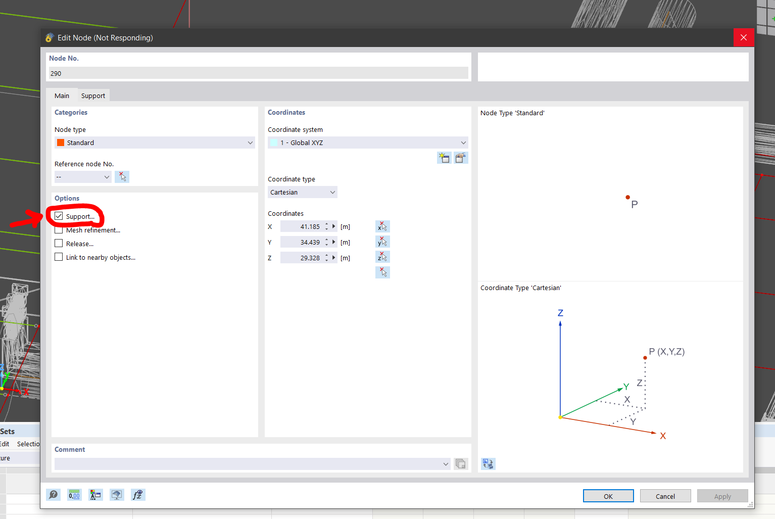

I Imported a large electrical and piping ifc model as a background object to guide structural modeling, using an RFEM version 6.11.0006. The size of the ifc model is about 200 MB.
Despite using a powerful laptop** and setting the battery mode to best performance, the RFEM application slowed down to almost becoming unusable, so much so that it took half an hour to import the ifc and only clicking on a checkbox takes so long I was able to walk around, get a coffee, scroll on my phone and write this post, and the checkbox hasn't worked yet ...
